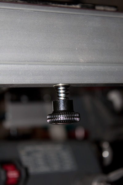

Btw, is the "button head screw" the old locking screw? If so, does the kit mention that it is no longer used?
Yes, the button head screws are the new locking screws.
Front extension table screw:
[ATTACH]5904[/ATTACH]
Notice the spring around the threads? I assume it is so the locking bolt will not vibrate loose during use, especially without the extension tubes being used.
