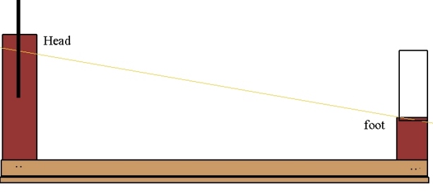

1-Cut a 2" x10”x 18" in half and stand each half on end 30"a part. Or as far apart as you want. Then with a straight edge mark your angel (Yellow line).
[ATTACH]7144[/ATTACH] FOR SOME REASON ATTACHMENT DID NOT COME UP> SEE NEXT POST.

1-Cut a 2" x10” in half and stand each half on end 30"a part. Or as far apart as you want. Then with a straight edge mark your angel (Yellow line).
[ATTACH]7149[/ATTACH]
