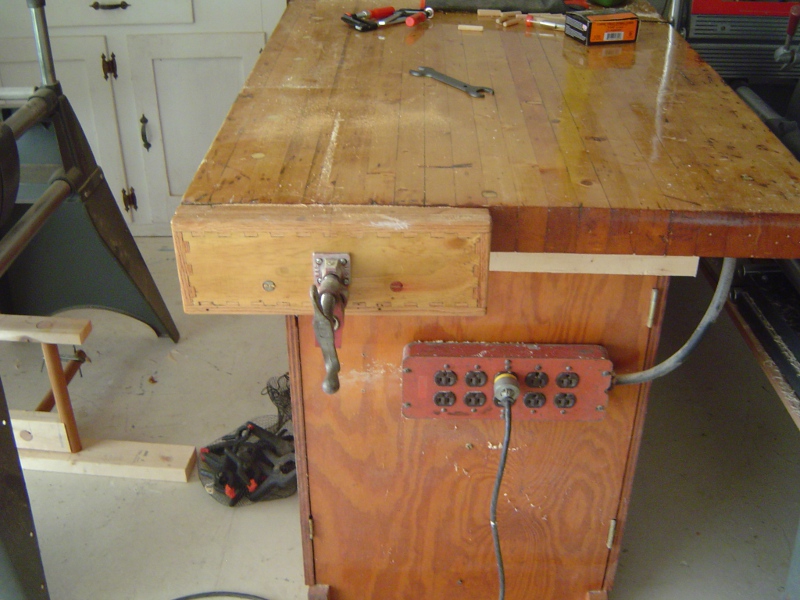

This isn't a direct answer to your question. It does, however, work well for me so I thought I would share it still. I just use a 3/4" MDF table that I clamp to my bench vise.
[ATTACH]9143[/ATTACH]

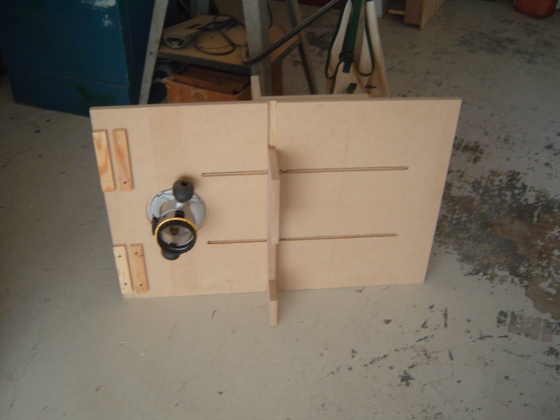

Under my table I inserted a clamping board into a groove with a cut-out to fit around my vise tubes:
[ATTACH]9144[/ATTACH]

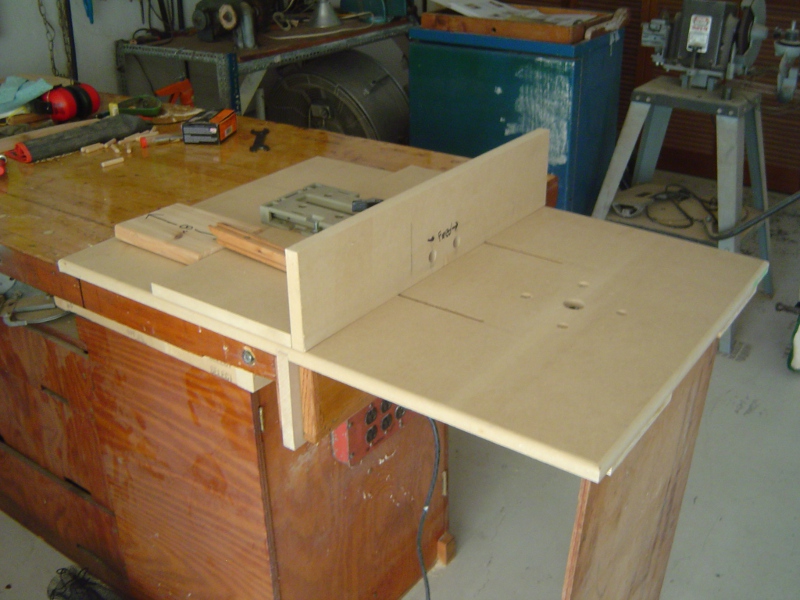

Here it is clamped in with a fence. I also have a pin routing attachment that I can set up pretty easily. I'm creating a video about that to post to youtube now, but I don't know how to yet and am stumbling through that process. I did edit out the parts where I bumped my head already lol.
[ATTACH]9145[/ATTACH]
The only reason I avoided building something to use on my shopsmith is because I wanted to leave that available for other operations. The router table is oversized for large pieces. It also has two grooves routed through the table so I can hold down the fence and some day the pin router attch with carriage bolts.
So far this has worked very well for me. I would call it a 2nd generation prototype. I had a router table that was hinged to an end of my workbench. When I moved I situated the bench as pictured and now dont have access to both ends.
I hope you like this.

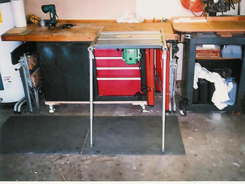

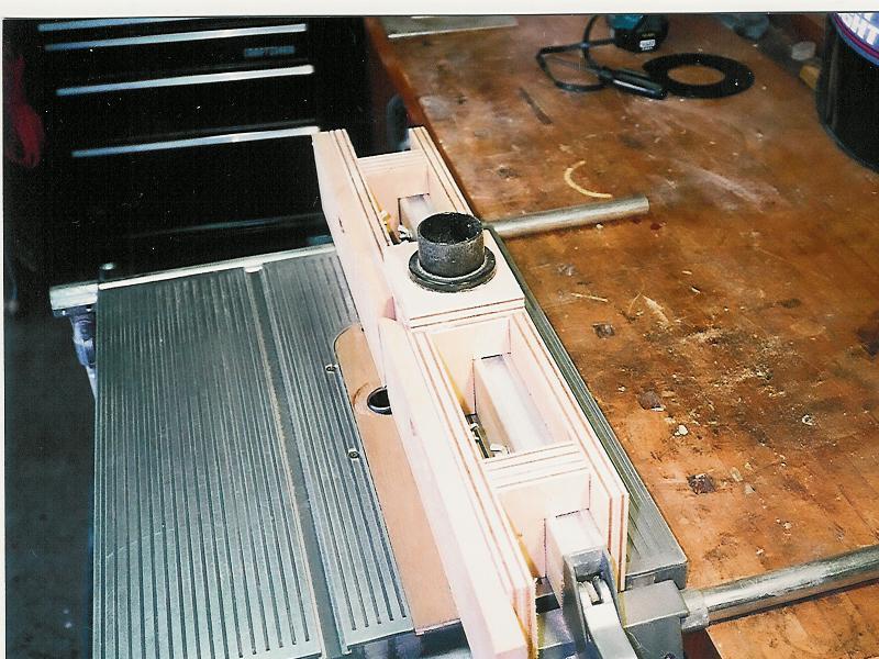

Here is my thinking.
I would make a table that could be mounted on the 500 Aux table that has legs.
I would then either make it so the 510 fence rails could be mounted on it or I would get 520 fence rails.
I would probably go the 510 fence rail route since you already have them.
I would then use the 510 fence as my router table fence. I would choose to use it over the 520 fence just to make sure I didn't oops it and have a router bit chew up my 520 fence.

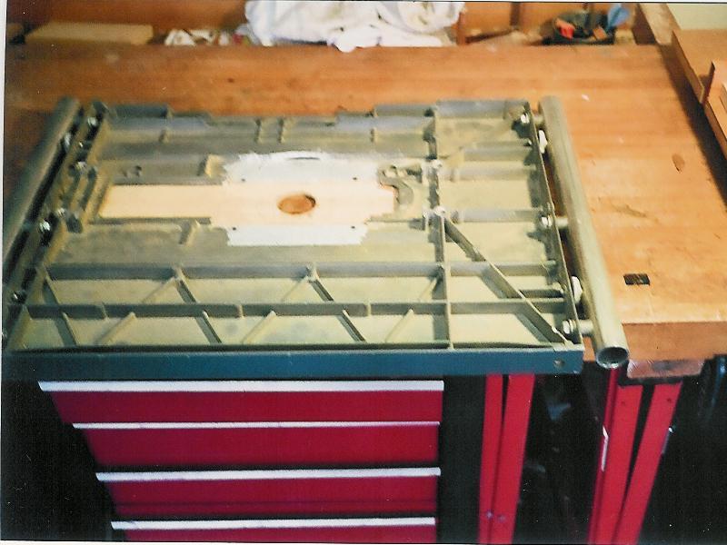

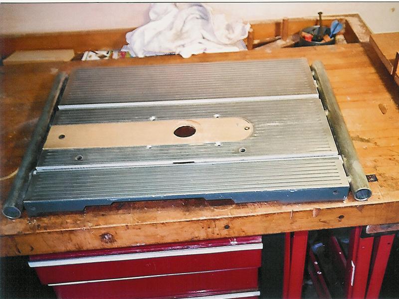

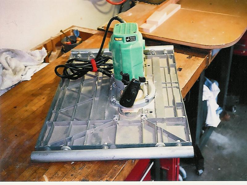

You may or may not know I had a bad 510 main table so I grounded a flat for mounting my router into the bottom of it and used my 510 fence with a built aux fence that collects dust and all. My setup works for me. imount mine on my workbench but if you used your aux table you could mount yours to the SS which I would like better.
Here is a picture.
[ATTACH]9165[/ATTACH]
[ATTACH]9166[/ATTACH]
[ATTACH]9167[/ATTACH]
[ATTACH]9168[/ATTACH]
[ATTACH]9169[/ATTACH]
Here is a picture.
