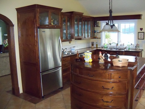

This may not show the corners too well but they are there. Sorry only shot I had that showed them at all... but of course, I digress.
