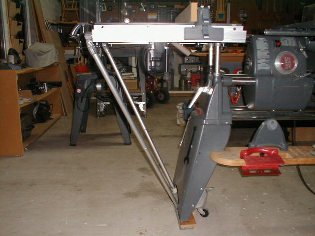

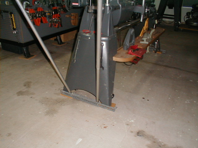

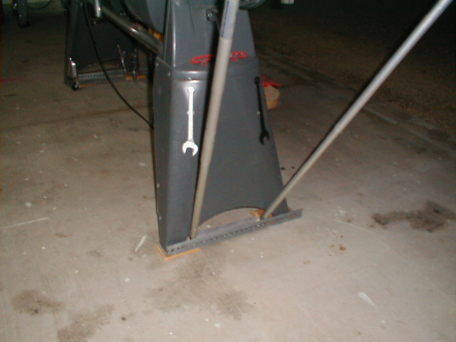

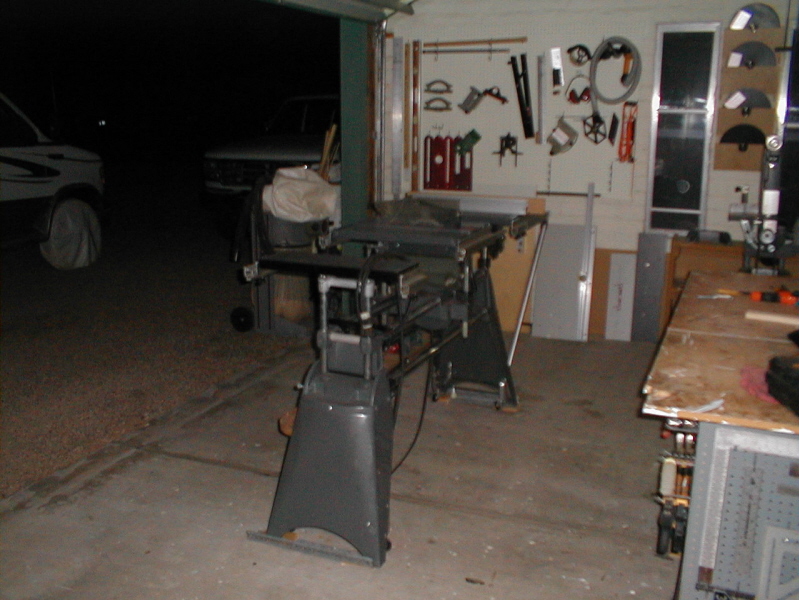

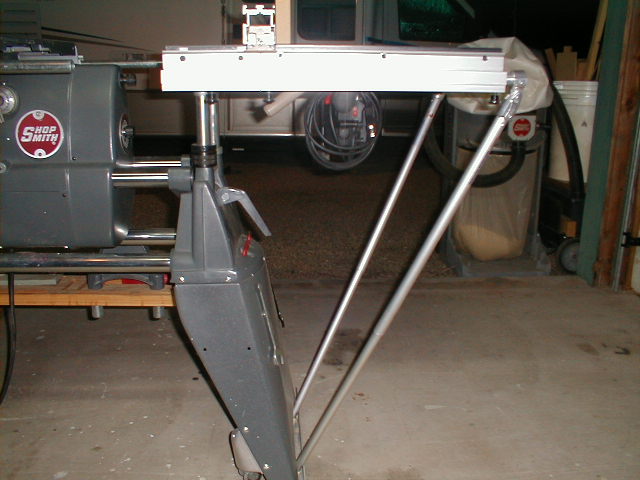

I've seen a couple of pictures now of people that have an extension (or auxillary) table mounted on the end of their Shopsmith that have the downward support legs coming back to maybe the bottom of the Shopsmith legs (Dusty is one I remember off hand). I can't see the bottom because of the photo's, but I assume that's where they fasten. Is this something you guys just came up with and did you have to modify either the support leg or the Shopsmith leg to get it to work. It seems like that would work well for me as I have to constantly move the Shopsmith to make room for parking vehicles. Does anyone have a photo that clearly shows how the support legs mount at the bottom?

Why not take a few photos. The more I take, the better, maybe. My grand daughter says its futile. I can do only so good with only 1.3 mega pixels.
Here's what I can do. Hope they help.

- PB110001.JPG (53.91 KiB) Viewed 13719 times
- PB110004.JPG (57.81 KiB) Viewed 13710 times
- PB110007.JPG (56.52 KiB) Viewed 13704 times
- PB110014.JPG (56.89 KiB) Viewed 13696 times
- PB110017.JPG (240.68 KiB) Viewed 13697 times
Thanks Dusty!
Dusty,
Thanks for all your effort. That's about what I pictured. Since I have to move mine, I could do something similar and bolt it to the SS legs.

Dusty:
Thanks for the pictures. I have found it a pain to try and secure my extension legs on my uneven floor. Your set-up might solve that problem as well as remove the chance of knocking them as you mentioned.
