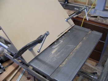

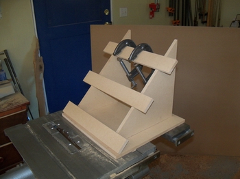

If you do have a Shopsmith, and you are inquiring on a SS forum, you might try this:
[ATTACH]10299[/ATTACH] [ATTACH]10300[/ATTACH]
