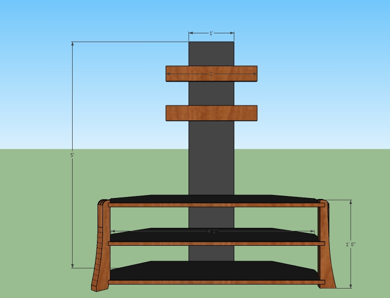

So here's what I have so far. Only slight revisions to the above. A double pedestal as per JPG's suggestion. Some trim on the front of the shelves to reduce sagging as per shipwreck - er, I mean shipwright.
[ATTACH]10320[/ATTACH]
The angle iron to prevent shelf sag was a good idea and I'll give that some thought. I wonder if I could cover it with wood trim? Or what about aluminum angle? If I polish it, that might be an attractive accent in addition to serving a valuable function.
And since angle iron/aluminum was brought up, could that be used inside the pedestals for added strength? Maybe a piece of 2" or 3" angle iron or aluminum in the front outside corner of each 3/4" MDF or plywood pedestal running from floor to top? Then the bolts for the cleats going through the cleat, MDF/ply, and angle?

I recalled that we had some spare parts from a video conference system we installed at work a couple years ago. That system uses big 52" plasma monitors. The installer told me I could have them and do whatever I wanted to do with them. I shoved them into a closet and haven't touched them since, so I went to see what was there.
I found 3 steel box tubes (I guess that's what they are?). They are 1"x3"x5', have a wall thickness of 1/8". To get an idea for their strength, I laid one down with one end propped up a few inches off the floor and carefully stood on it. Standing on the wide (3") part, there was some noticeable flexing, but it held my weight (and I'm a lot heavier than that TV). Standing on the narrow (1") part, there was no flexing that I could feel or see from my view.

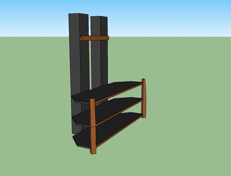

So my new idea is to go back to one pedestal (my preference), but make it about 1' wide. Inside the pedestal, attach one of these box tubes to each front corner and one centered between them. Then attach two cleats (each 6" wider than the pedestal - or even more than that if required by the mounting hole locations on the TV itself), instead of just one, to keep the TV from rotating with each cleat tall enough to have two bolts through the cleat, outer wall of the pedestal, and box tube at each box tube location. Actually, I'm not even sure that the box tube in the center is necessary. Seems to me that this would be plenty strong. Thoughts?
[ATTACH]10321[/ATTACH]

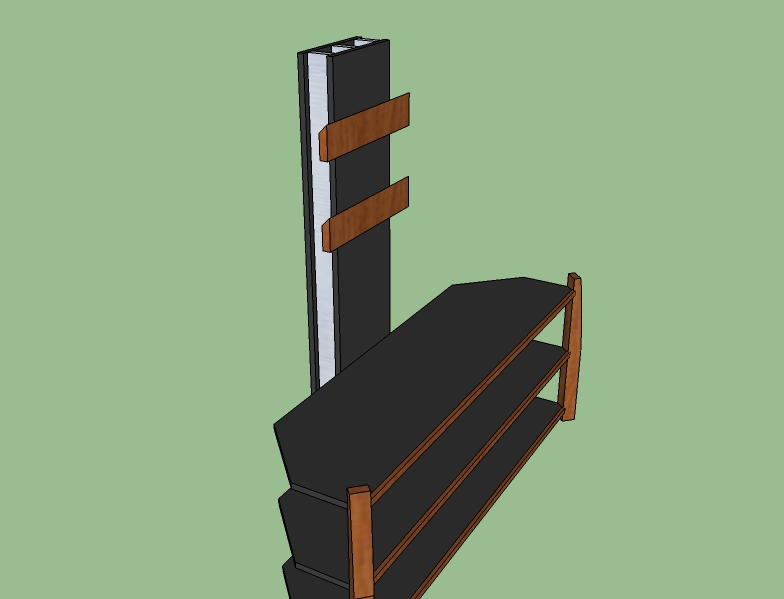

The shelves need to be 50" wide and 18" deep. There's going to be some sagging problem regardless of whether I use MDF or plywood. I liked the angle iron (or aluminum?) suggestion, but I would still like to cover it with a hardwood strip.
The current version of my plans is for a strip of angle in the front and back of the shelf. In the back, the angle can be bolted to the box tube upright supports in the pedestal and the shelf attached to the angle. That should hold the shelf and help reduce sagging.
[ATTACH]10338[/ATTACH]

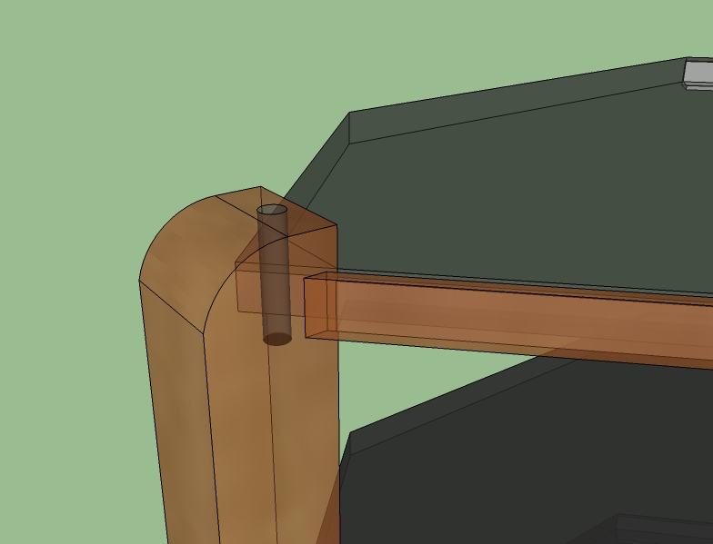

I'm still just not sure how to attach the front legs. I still want them one piece and outside of the shelves. Perhaps dados on the leg with a dowel for additional support?
[ATTACH]10337[/ATTACH]

in terms of the front legs, just in terms of my experience, I would not rotate the front of those legs into the front edge. I always seem to find that new equipment is wider than old and I want that extra inch or 2 of width across the front. also, I hate it when the side of my current system blocks the IR beam of the remote from reaching the control sensor in the cable box. for me, I would put those legs on the side near the front and make them trapezoidal in cross-section with the smaller face inward. of course, SWMBO thinks that I have a weird sense of aesthetics;)

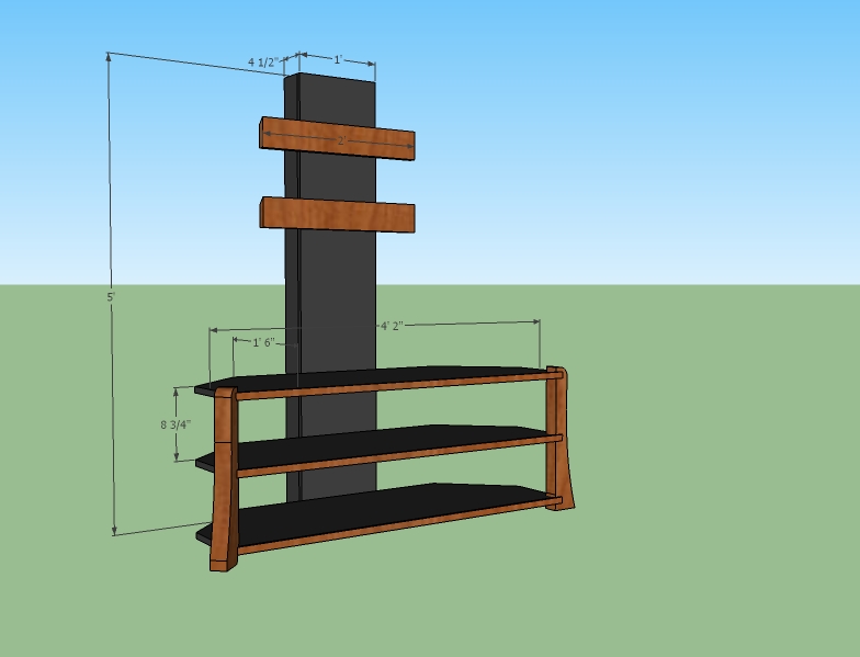

heathicus wrote: . . . Actually, I'm not even sure that the box tube in the center is necessary. Seems to me that this would be plenty strong. Thoughts?
The 'center' is probably over kill and complicates the cabling access to the shelves! The space between them would be larger without the 'center'.
The 'center' could be cut and used in the front legs(?).
As for the tilt, consider using a tiltable tv/wall mount. The wall mount could be attached to the french cleat(s). I agree you need to include a 'french cleat jumper outer preventer'.

" wrote:in terms of the front legs, just in terms of my experience, I would not rotate the front of those legs into the front edge.
You bring up some good reasons for that, but... I just really like the legs on the corners and at an angle to the shelves. In Sketchup, I had put one leg on the side like you suggested for visual comparison to the other leg. The joinery that way would be easier, but it just doesn't please me as much visually.
[ATTACH]10351[/ATTACH]
The rest of the stand is rather plain and boring, so I want to do something a bit more interesting and elegant (while remaining subtle) with the legs.
