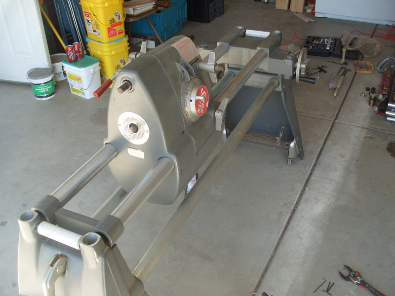

I talked with a few acquaintances and neighbors, read the original manual and detailed shopsmith book that my uncle purchased, broke out my hand tools and multi-meter and carefully stripped down the unit for maintenance.
There was still quite a bit of sawdust in almost every nook and cranny, but the belts and motor were in superb condition, all the stop/locks were in good working order and all attachments to basic functions were there and in labeled containers except for the lathe cups so I am going to wait on anything to do with that function until I've become more comfortable with other functions.
As per the shop manual I lubricated (oil, graphite or wax as appropriate) the parts that were called out and made sure I had an isolated circuit in the garage.
Unfortunately before I do any serious work I'll have to add a new circuit as the entire garage is on the same breaker (20 amps) and I like my "beer fridge" to stay where it is, but my laundry room is on a separate circuit so that's not a concern.
I checked the basic functions of the table saw and drill press and everything ran smooth.
I'm looking forward to getting a few low key projects done to make my closets and kids' toy room a bit more functional before I start tackling some of the more difficult things such as custom inlays or major lathe work.
I'm very grateful to both my departed uncle and my father for letting this wonderful machine come to my family and I hope that everyone here can share in my shop re-education.

- Base-Unit.png (763.2 KiB) Viewed 3497 times

Drewcof, welcome to the SS forums. Nice looking machine ya got there. But WHERE'S the inside of the leg rust?
The 'PO' did not have felines!:D Nor heavy dew!:rolleyes:beeg wrote:Drewcof, welcome to the SS forums. Nice looking machine ya got there. But WHERE'S the inside of the leg rust?
