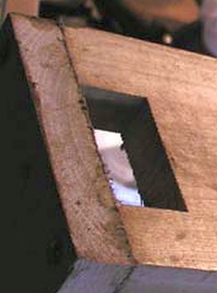

Well, the first few pics show boards made from three. That's pretty obvious.
As for the rest, or using a tool, a darn good cut can be made with a jig saw or a band saw, using the same cutting technique for either.
One can also use a dado blade on the table saw.
Crisp Cut In

Obvious glue lines?????
[ATTACH]12070[/ATTACH]
All I see is grain!
Bottom looks like dado was used.
- framejig1x.jpg (40.57 KiB) Viewed 1966 times

Apparently one person's grain pattern is another's glue line.foxtrapper wrote:Zoom back out and you can see the seam lines. It's visible even zoomed in like you have it. The top seam is more obvious than the lower.
I emailed the guy on the web page and here is his answer:
Hi Joe. Since I only had 4 to do, I just used the table saw blade cranked up to that height and nibbled it away by making repetitive cuts. You could also use a dado blade, a router bit, a coping saw, or even a chisel and mallet.

Huh, maybe that glue seam isn't as obvious as I thought.joedw00 wrote:I emailed the guy on the web page and here is his answer:
