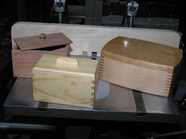

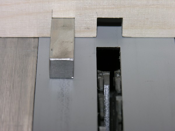

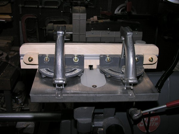

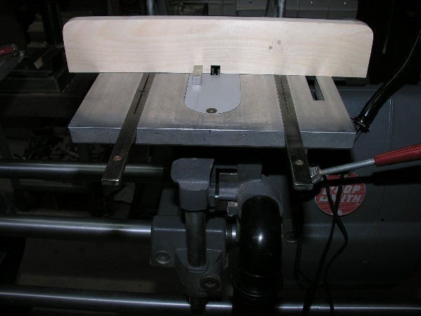

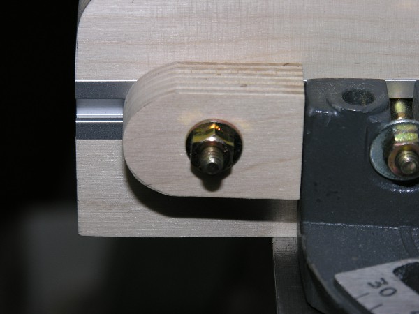

Perhaps a little out of tune in that this thread was on router tables and I got into box joints, anyway this another method that I use with my Mark V. It is a simple jig, but by using feeler gauges I can dial it in very quickly. The one in the pics is a 1/2" jig.
The box joints in the little boxes were cut with the router sled.
If there are any questions give me a ping.
