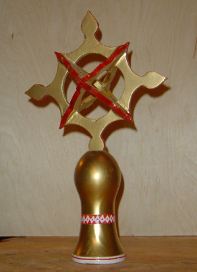

I made a couple of these for Christmas gifts last year. I only used the jigsaw to make a template to use at the router table, but it's a great tool for this kind of work.
[ATTACH]12729[/ATTACH]
I got kinda lucky last year and scored a bunch of SS jigsaw blades online, but I understand that you can also purchase 5" jigsaw blades from the big box stores. If they only have pin blades then you can pull the pin off and use it that way.
Have fun with your jigsaw :) It's really cool to use. Just make sure that you have oil (non-detergent) in the reservoir.
