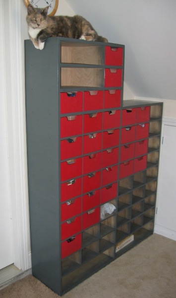

Phase I Complete
After 4 sheets of plywood, 360 dadoes and 129 rabbets, I finally finished Phase I (carcus and first round of bins). I took the advice of some of the replies (thanks to all who replied) and this is what I came up with.
Two more sheets of plywood, 208 dadoes, and 112 rabbets to go!
[ATTACH]13245[/ATTACH]

Really good work!!!!! One can see the straight lines and level shelves and know this is fine workmanship. You did your planning and milling with a lot of forethought. Also the drawer/box fronts show your planning and patience.
Congratulations! Mountain......

Sweet I may have to make me up some of those cubbies. Very nice work indeed!

Only because I am jealous, I must hate you now! Just kidding! I have wanted to do a similar project, but just haven't taken the time and $$ to do it. VERY nice job!! jimsjinx
