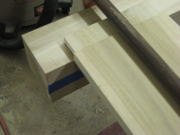

I'm building myself a new workbench and with it, I'm experimenting with mortise and tenon joints. My question is this: When dry fitting the M/T joint, how loose/tight should it be? Right now, I can push them together with a little help from a rubber mallet. Will this be too tight with glue applied?

That really depends on how big your rubber mallet is.:)
Even without glue, the joint should be very snug. But yes, you can get the fit too snug. I suggest that you cut and glue a test joint. Also remember, a joint that fits today may be too tight (or too lose) tomorrow.
mountainbreeze wrote:I'm building myself a new workbench and with it, I'm experimenting with mortise and tenon joints. My question is this: When dry fitting the M/T joint, how loose/tight should it be? Right now, I can push them together with a little help from a rubber mallet. Will this be too tight with glue applied?
Sounds just about right to me, as long as the shoulders fit nicely! Sliding in and out like a drawer is too lose for a good joint.

I've had trouble with dowels fitting after the glue was applied. This can be a frustrating problem because you are "on the clock" in regards to the glue drying. I would loosen the tennons until they can be fit by hand only. Then, after applying the glue you will likely need that rubber mallet.

When I make a tennon joint, I always make them snug. I also pre saturate the glue surfaces with a little H2o to wake up the grain. If it gets too tight, I'll pare a tiny bit of material and re-fit. Now when coated with glue, it soaks right in, and I get even squeeze-out all the way around. I have never had a joint pull apart in 35 years. Tightbond 2 and 3 are my glues of choice. If I had one piece of advise, it would be to make sure the tennon does not rest against the bottom of the mortise. I always leave about a 16th of clearance for glue at the bottom. Also, if the tennon is wider than about 3 inches, split the tennon in the middle. This will allow the board to split under pressure a tiny bit at the shoulder, but the joint will NOT pull apart. jimsjinx
