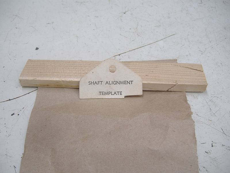

I was out in my shop today rearranging things and found mine. I haven't seen it in years.
So where is yours? Did you ever have one?
[ATTACH]14007[/ATTACH]

This was an aid to align the 1/2" shaft tools to the 5/8" shaft on the headstock. It is print on light card stock so I don't think they intended for people to have them forever.

reible wrote:This was an aid to align the 1/2" shaft tools to the 5/8" shaft on the headstock.

algale wrote:Excuse my total ignorance but ... 1/2" shaft tools?
Certain SPT have a 1/2" shaft rather then a 5/8" shaft. The scroll saw and jig saw are two that come to mind.

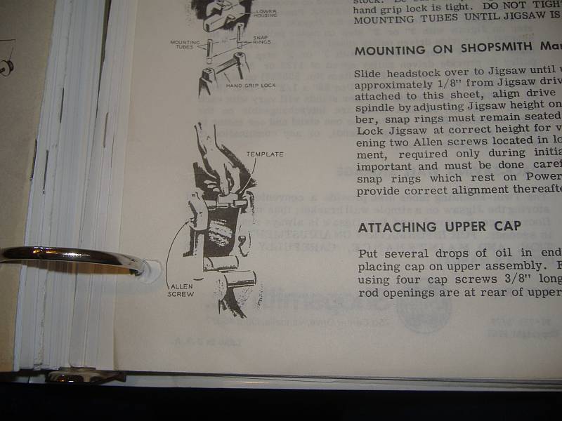

The off set is 1/16". This was a way to insure that the 1/2" shaft tools, say the jig saw was to be aligned to the headstock output shaft which is 5/8". The gauge was used to get both horizontal and vertical alignment. Here is a picture to show it being used.
[ATTACH]14013[/ATTACH]

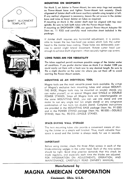

Alignment guide circa 1962
Here is mine - printed on a page that came with jointer in 62
[ATTACH]14014[/ATTACH]
