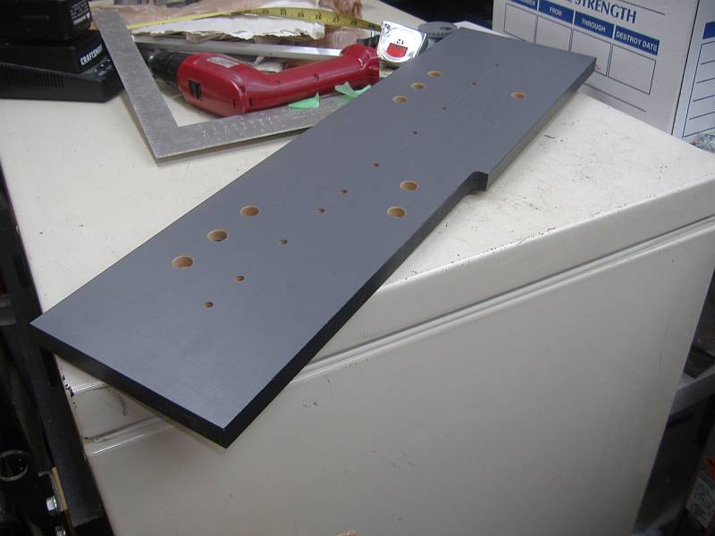

I do not have the jointer but i do have the shopsmith auxiliary fence (555653). Paper work reflects 5/99, so it has to be since then that I got it.
I did a quick review of how it is built and then took some ruff measurements. First an over view of the part.
[ATTACH]14257[/ATTACH]
Using the right side as a reference the first hole is 7" in, the second is 17" and the last hole is 18-3/4. The first and last hole appear about 1-5/8 up from the bottom reference. The other hole is about 2-1/8" up. (holes are referenced from the lowest reference in virtual space for two of them).

My unknown version says to use 1" flat head screws, so no measurement needed. BUT on my fence, the holes are KNOT on an even plane. So 1 7/16 above the infeed table wood knot work to well.
So I measured the holes and came up with 1.5" above the infeed and 1 15/16 above the cutter.
