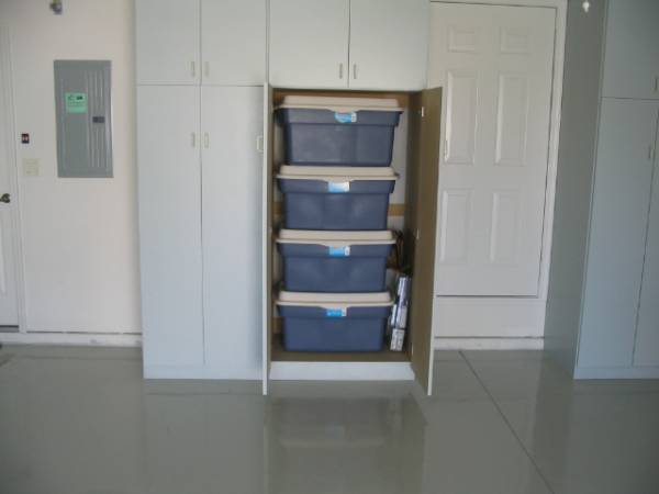

I have used the fence for some cross cutting when the dimensions were almost the same but used the miter gauge with an extended fence to cross cut the wider doors I also used the fence only to cut the dado in the side carcases to assemble the cabinets. The cabinet sides are 8' long and 24" deep but I used the two push blocks that came with the jointer to maintain control but of course these cuts were NOT through cuts.

- garage cabinets 2.jpg (11.47 KiB) Viewed 2709 times
- garage cabinets.jpg (22.64 KiB) Viewed 2706 times
