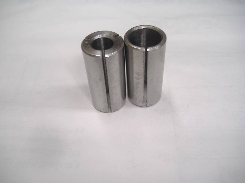

This is not saying that it will work with the speed increaser setup because I have yet to see how the two screws hold things. The thicker adapter has a through slit and 2 notched slots to allow it to flex better I guess. The thinner adapter just has the through slot. I took a quick picture of then for you to see:
[ATTACH]16727[/ATTACH]

Can you remove one of the set screws and take a pix?tmoltzan wrote:Here is the view of the speed increaser "Chuck" with the two set screws advanced. I am still contemplating what to do, but am watching the other thread with great interest as well.
They appear to be brass tipped full dog point. The od of the point is meaningful.
OD of the dog and length of the dog. If both od <= 1/4" and length > 1/8", making an adapter from a sleeve should be relatively easy assuming reasonably concise drilling.tmoltzan wrote:I'll take a screw out and put it on a micrometer when I get home from work, but it won't be until later tonight.
