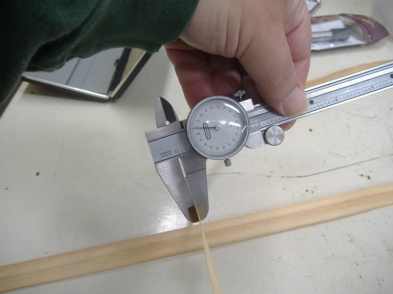

A couple of rules I use for thin strips.
ALWAYS use a ZCI
Nothing thinner then 1/8" between blade and fence. (Requires special equipment to get this thin, examples being, Grr-Ripper, Fence straddler, special spacer fence, splitter to name a few).
Rip blade, glue line if possible.
Thinner then 1/8" cut to the outside of blade.
I have managed cuts to the .003" to .004" range but at that point it becomes difficult due to blade "wind" and other issues. When you get to about .007" it is easier.
BTW the thin cuts I did this thin were for a project my wife want to try. Bookmarks with "paper punch" designs. In order to punch them they have to be quite thin.
Right now I don't know if she has any left for me to show you. About the best I can do is show you this .010 thick ribbon that is from another craft project.
[ATTACH]17298[/ATTACH]
