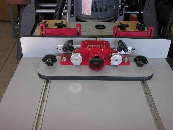

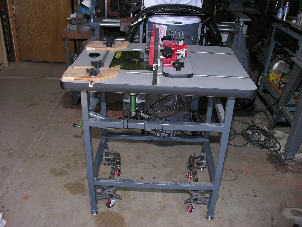

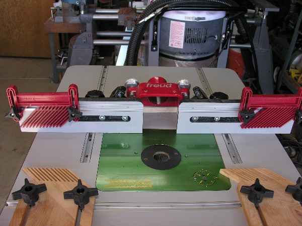

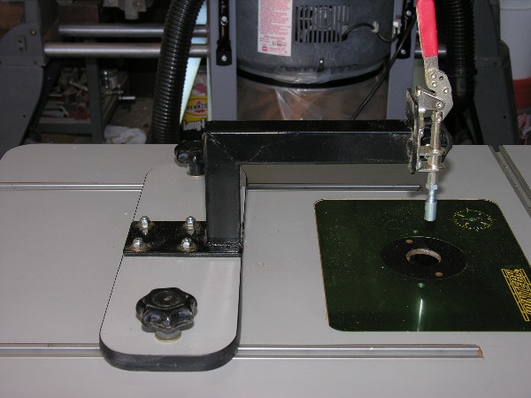

Over the years I have built several router tables and have yet to build the perfect one. The under table will do some things quite well and the over arm
OPR can do many things well. I have both so I usually get the job done. I have never posted pictures so I will try it now with the last router table built and the one I use today. If you have any interest or want some info on the table give me a ping. I see I can only put five atachments with this post I will try and get the rest in another post.
ldh
ldh
- DSCN1176.JPG (81.68 KiB) Viewed 13448 times
- DSCN1177.JPG (83.24 KiB) Viewed 13429 times
- DSCN1178.JPG (57.48 KiB) Viewed 13427 times
- DSCN1179.JPG (66.77 KiB) Viewed 13420 times
- DSCN1181.JPG (78.07 KiB) Viewed 13422 times
Router table
The remaining jpgs
ldh
ldh
- DSCN1183.JPG (72 KiB) Viewed 13423 times
- DSCN1184.JPG (58.91 KiB) Viewed 13415 times
- DSCN1185.JPG (53.38 KiB) Viewed 13412 times
- DSCN1186.JPG (56.2 KiB) Viewed 13409 times
- DSCN1187.JPG (54.99 KiB) Viewed 13417 times

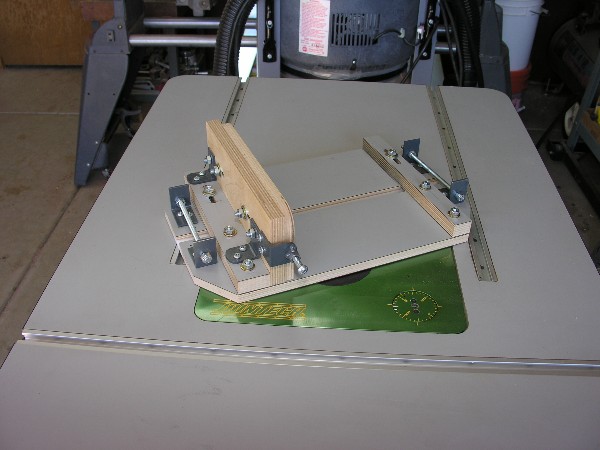

Doug,

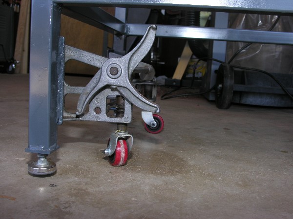

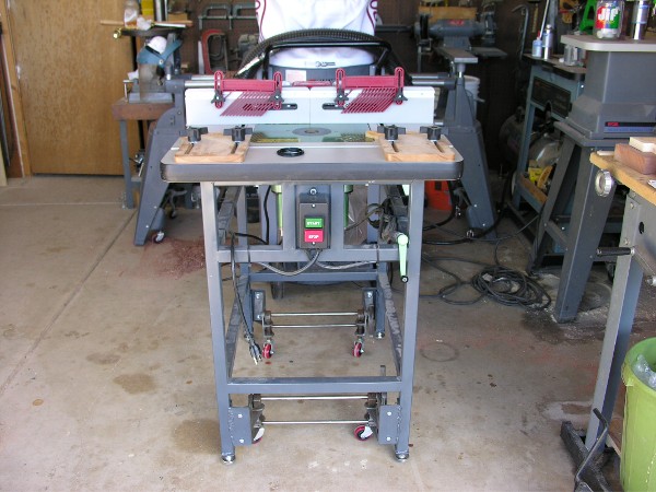

The caster set is from a SS 10ER from the 1950s. I like to use them as they work well on straight legs. You can use the Mark V casters, but then you have to weld up an angled bracket to attach them to straight legs. The steel wheels on the set were replaced with urethane wheels to handle the weight of the table. The frame of the router table is of .065 x 1 1/4 tube steel.

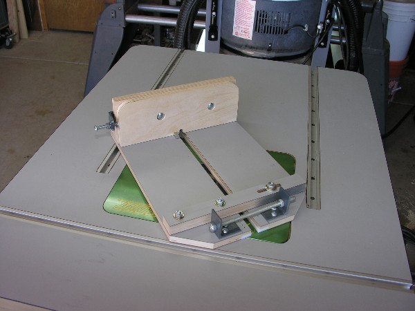

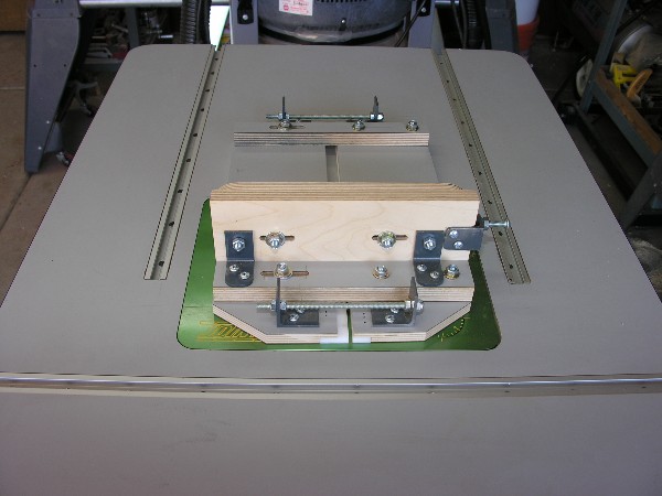

The sled is a jig to make 1/4, 3/8 and 1/2" box joints. It follows the respective PC guide mounted in the router plate. It is adjustable to take up any play in both the guide and adjustment of the pins. Works quite well. I like to make boxes. I also have a jig that fits my Mark V that uses a dado blade and is fully adjustable. If there is any interest I will post a pic.
ldh
