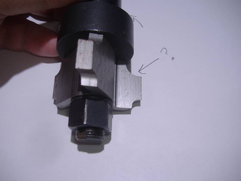

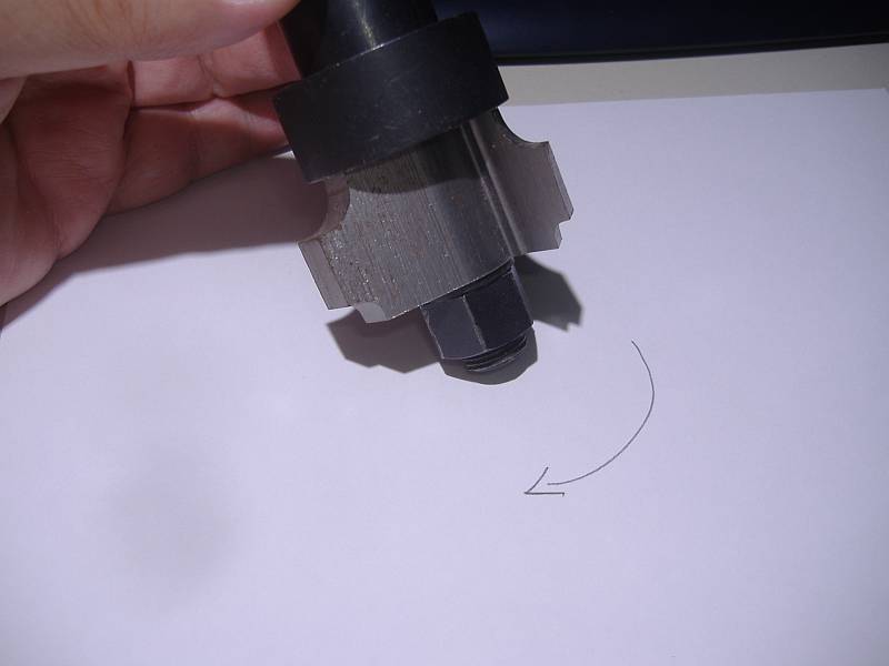

Below is a picture of the shopsmith 1/2" arbor with a 1/2" shaper cutter mounted. This would be what you would set up in the drill press mode.
[ATTACH]17622[/ATTACH]

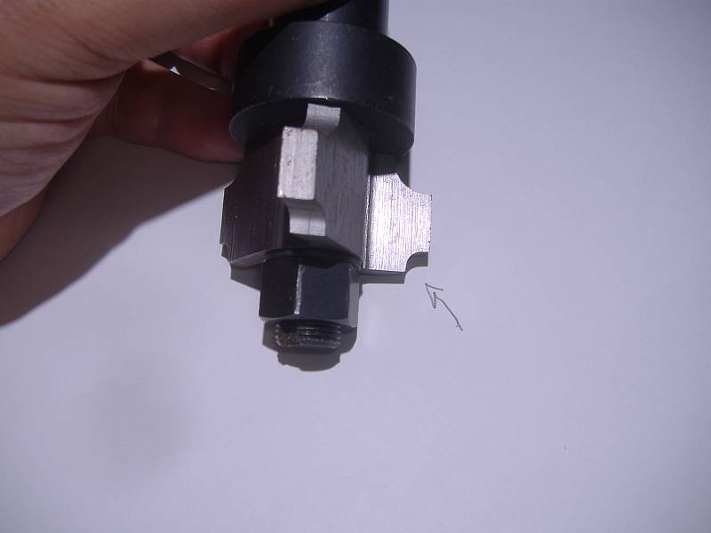

Note the rotation of the shopsmith in forward rotation. As you can see the cutting edge is in the proper direction for the small round over cut.
[ATTACH]17623[/ATTACH]

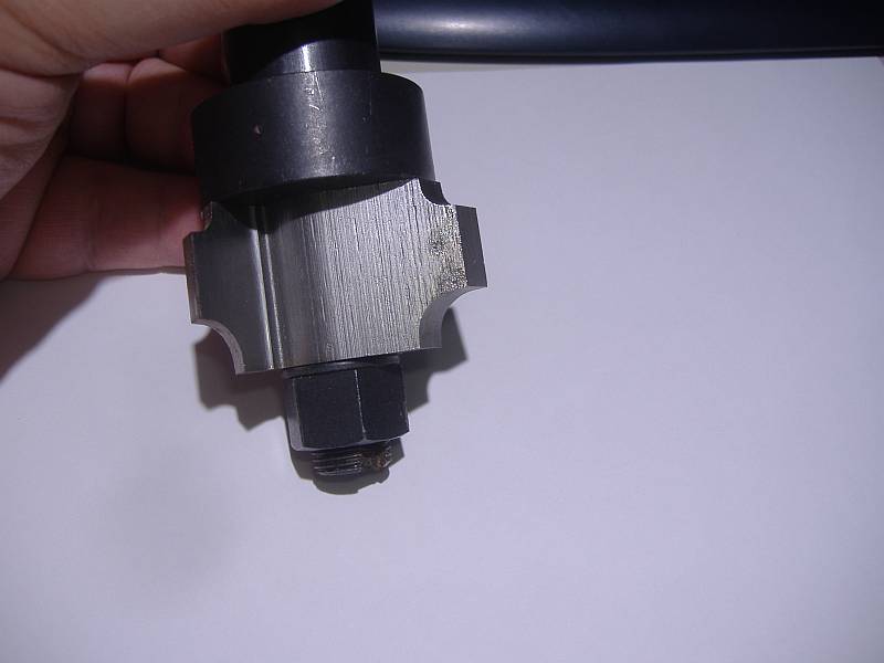

However what if we wanted to use the larger round over? You can't use it as mounted so now what?
[ATTACH]17624[/ATTACH]

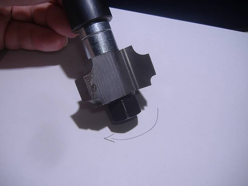

The obvious solution is to flip the cutter over. So we go ahead and do that. Now we have the portion of the cutter we want but we also have a problem. As you can see the bit will be running backward....
[ATTACH]17625[/ATTACH]

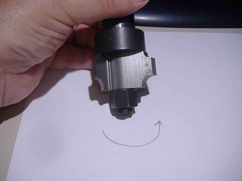

Solution? Flip the switch to reverse, that is if you have it.
[ATTACH]17626[/ATTACH]
Now you can go on cutting.

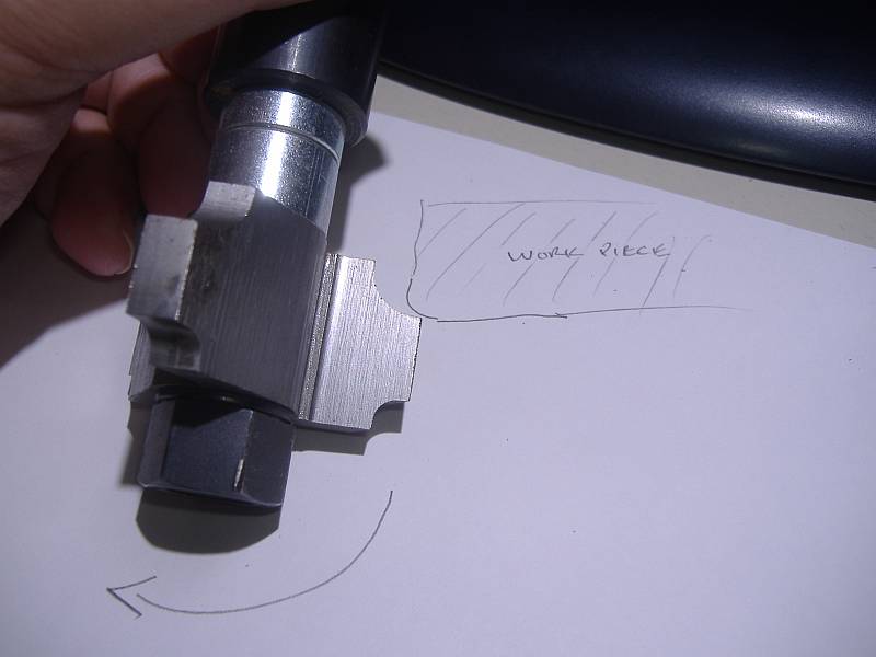

The above post was true to a point but depending on how thick the work piece is and other factors.... There is another way that might work for us.
The use of some spacers can provide a way of moving the main part of the bit below the table, putting the cutting edge just above the table (think drill press mode).
[ATTACH]17627[/ATTACH]
[ATTACH]17628[/ATTACH]
So this is really cutter/operation dependent but certainly worth looking at when you are making your decisions.
