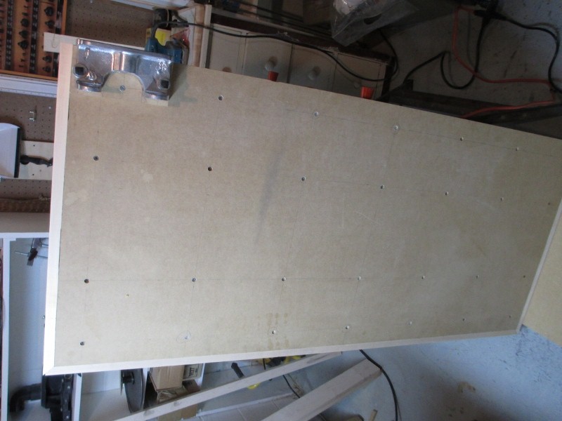

Well real visible progress today as I attached the sides and back of the apron to the workbench . Here is the underside (sorry about being sideways:( ):[ATTACH]17958[/ATTACH]

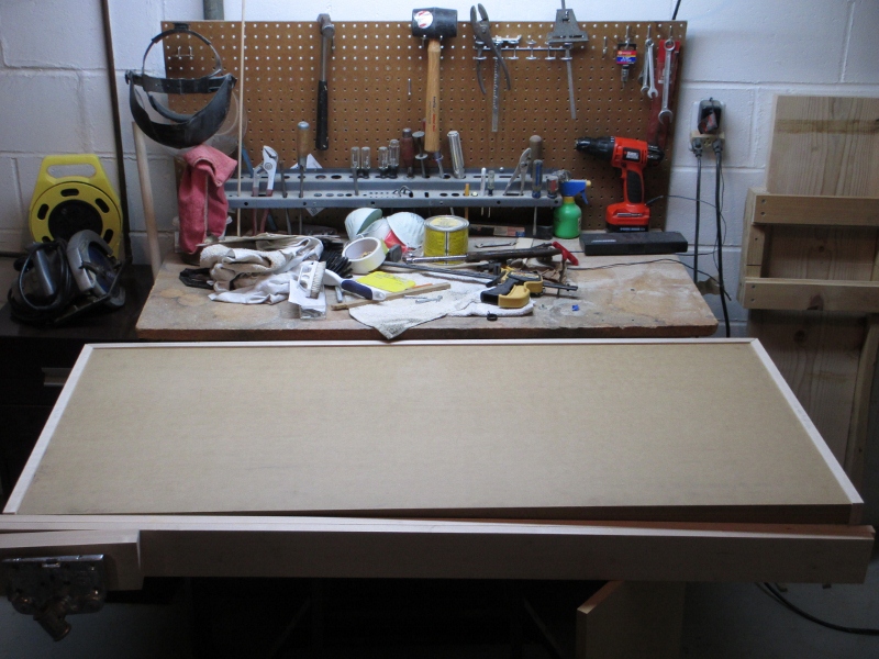

The next picture shows the top side with the front piece of the workbench and vise face waiting to be added.[ATTACH]17959[/ATTACH]
The workbench getting this top is in the background.

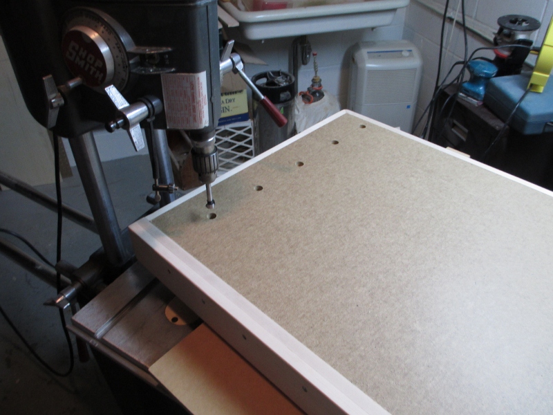

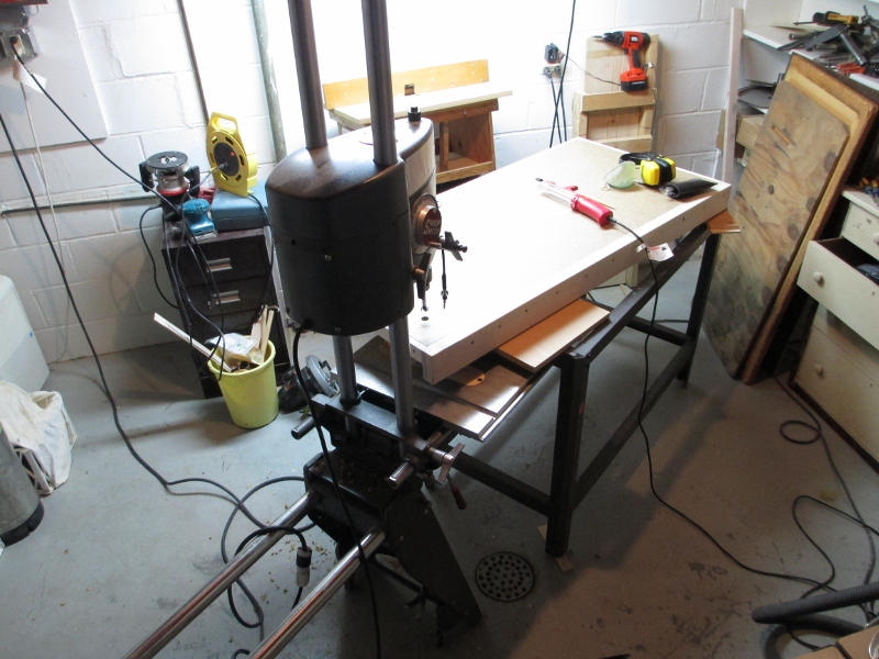

To get it done, I had to get a little creative. Not sure this is a good way to get familiar with the drill press:D
[ATTACH]18024[/ATTACH]
got a nice row of holes
[ATTACH]18025[/ATTACH]

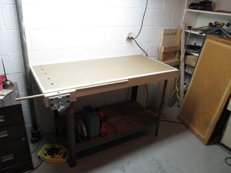

Attach the top to the frame and it is done!!
[ATTACH]18026[/ATTACH]
It has more than its share of 'unique features':D ...but it is functional and done.
