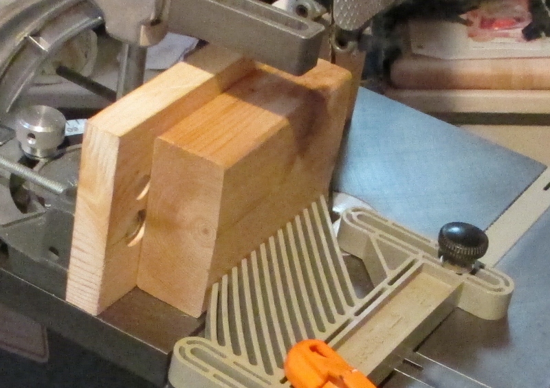

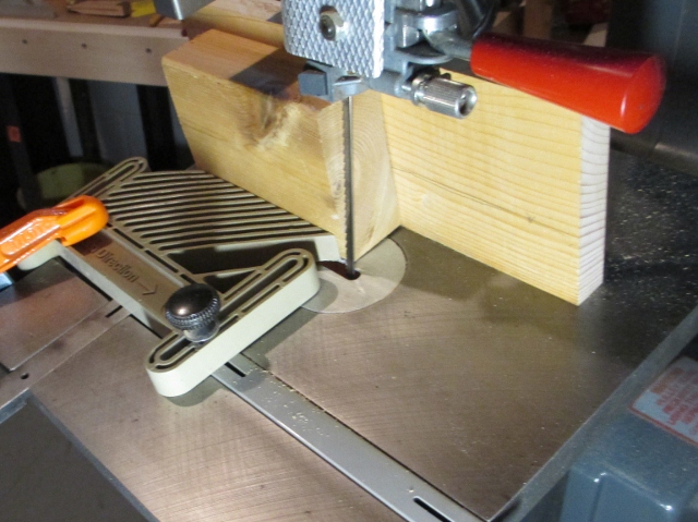

Well things did not go too well last night. This morning though I took another run at and had more success. First I tried doing the cuts using the table tilted with a fence tried it a couple of times. I am not sure why the set up did not work, but it did not get close.
[ATTACH]18100[/ATTACH][ATTACH]18101[/ATTACH]

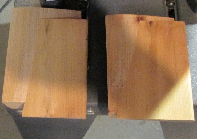

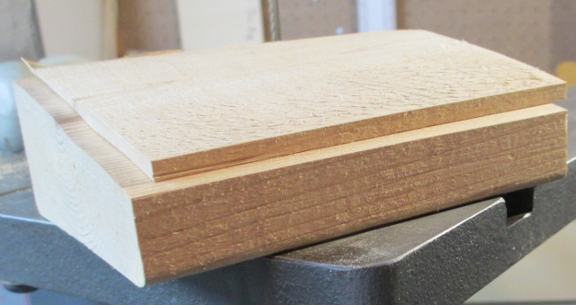

Not sure how best to show the results using this setup. I tried a couple if ways. The first was a shot of each board after it had been cut with the trailing face backed up to the blade.
[ATTACH]18102[/ATTACH]
[ATTACH]18103[/ATTACH]
I tweaked the miter setting between the first and second boards. Drift may be a little less on second board. The cutting away from line to waist side got bigger-this due to me not re checking. On both boards, I made multiple passes as slow as I could. It just would not go where I wanted. The next post will show the results a different way and the final results from this morning.

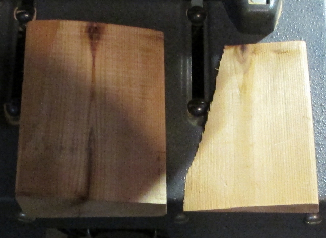

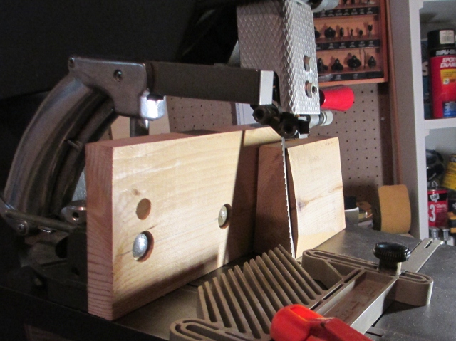

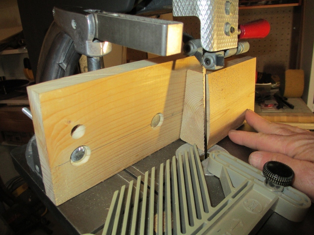

Here are some other views of the problem cuts:
[ATTACH]18104[/ATTACH]
The board on the right was first cut and the board on the left was after adjusting fence a smidgen. Next pic is first cut
[ATTACH]18105[/ATTACH]
Next is another pic of second board cut
[ATTACH]18106[/ATTACH]

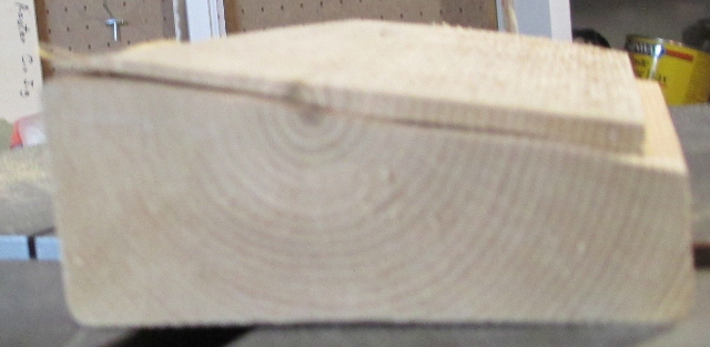

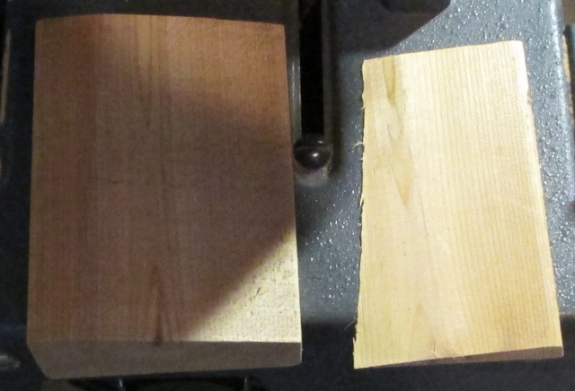

This morning I tried doing the cut freehand on a flat table with the workpiece standing on end (grain vertical). This went much better than last night. I will be able to sand these flat pretty easily, with out going through too much sandpaper I think.
[ATTACH]18107[/ATTACH]
[ATTACH]18108[/ATTACH]
I was able to get adequate surfaces on both pieces. I think the knot running down the length of the blocks was what was causing trouble as the blade was bulging/bowing out. I know if I were to do it again, I would see if steering against a point coming off a locked down miter wouldn't work better than a long miter face.

I wood have guessed a 1/4" blade. In the 3rd pic, the blade and cut look to be bowed. Think I wood have used the 5/8's blade myself.
Sam;
I would opt for the 5/8" blade with the 4TPI count. There several things that will make a bandsaw blade act as yours did.
1. Improper blade tension.
2. A dull blade
3. Teeth flattened on one side or the blade or too much drift.
4. Blade guide under the table not set properly. (the under table guide assembly is not adjusted and the blade runs free of the guide underneath the table.)
If the under table guide is set to contain the blade and you get a cut that looks like this ) or this ( then your feed rate may be too fast or the blade is just bad.
