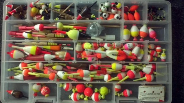

The types of bobbers or floats as some call them is endless.
[ATTACH]18351[/ATTACH]

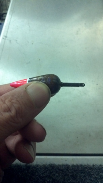

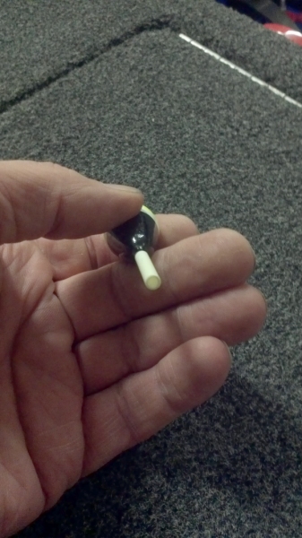

When made from wood the body is usually balsa for it's light weight. I can't recall ever seeing
a slip bobber with a hollow wooden center shaft that protruded beyond the balsa part more than about ½"
any longer than that were either plastic or they had a small hole going sideways through the very bottom.

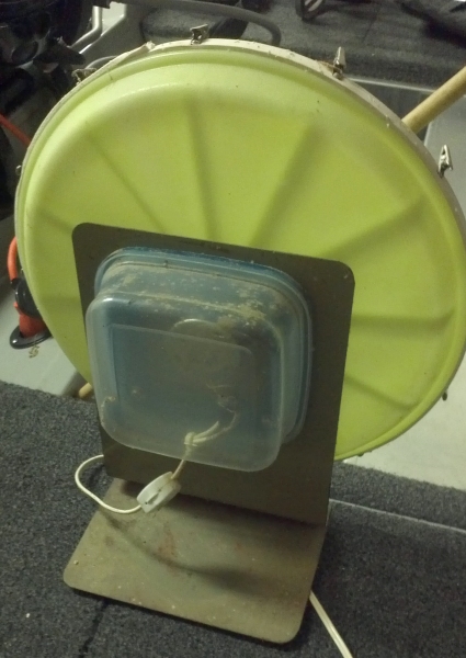

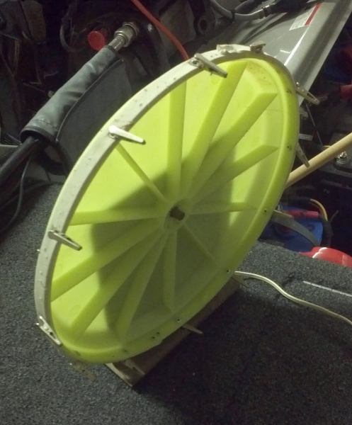

You will want to put an epoxy coating on them then paint. If you plan on making very many you really
should make something to rotate them while the finish dries this will come in handy for all kinds of things.
when it rotates the paint, epoxy etc. does not run/droupe to one side. I use mine on all sorts of small things.
Mine is a small 110 v 5 rpm motor that turns a 5 gal bucket lid with foam around the circumference to stick
jig and fly hooks in and alligator clips to hold whatever else I need.
