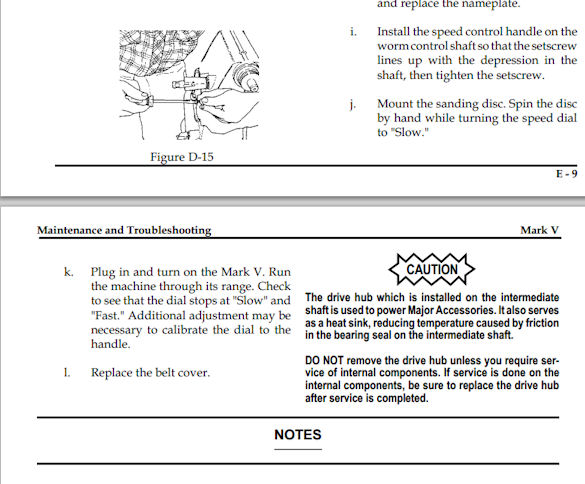

The first place I saw referring to hubs as heat sinks was here:
http://www.shopsmith.com/ownersite/prod ... e_1_10.pdf
The last page has a caution:
[ATTACH]20132[/ATTACH]
I knew I saw it somewhere and after browsing my collection of old SS docs on my computer for about an hour (a pleasant hour), finally tried Google, which found it in seconds!:o Since I leave the hub on all the time, I have no idea how "necessary" it is.
- caution.jpg (71.04 KiB) Viewed 2175 times
Peter
dusty wrote:Thanks, Peter. That makes it official. I'm going to leave the hubs in place just like I was told.
So am I(but not for cooling purposes).
I put this in the same category as some other pieces of 'wisdom' from SS Inc. that 'differs' from previous 'producers'.
I remain skeptical!;)
P.S. That verbage is not included in my 1986 vintage manual.
