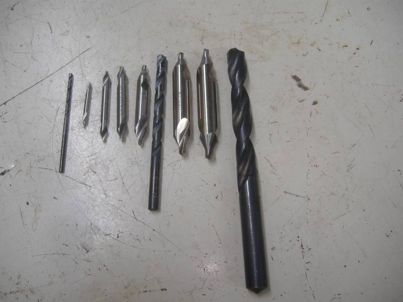

Hi,
Here are the ones I got from Grizzle a couple of years back when I discovered I no longer seem to have my original set. If I recall the 1 - 4 were a package deal and the 5 and 6 were separate. I've included a 1/8", 1/4" and 1/2" drill bit so you can visualize the sizes better.
[ATTACH]18336[/ATTACH]
Well worth having in a wood shop and really needed if you do metal work.
I believe I have posted some pictures and shown uses for these a while back, however I don't recall the subject(s).
reible wrote:Hi,
More gooder than a chart!;):cool:
