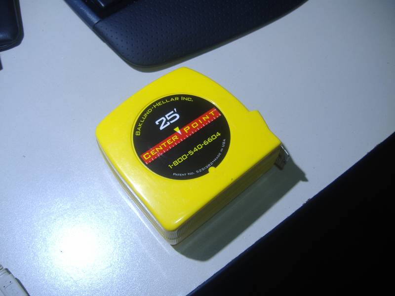

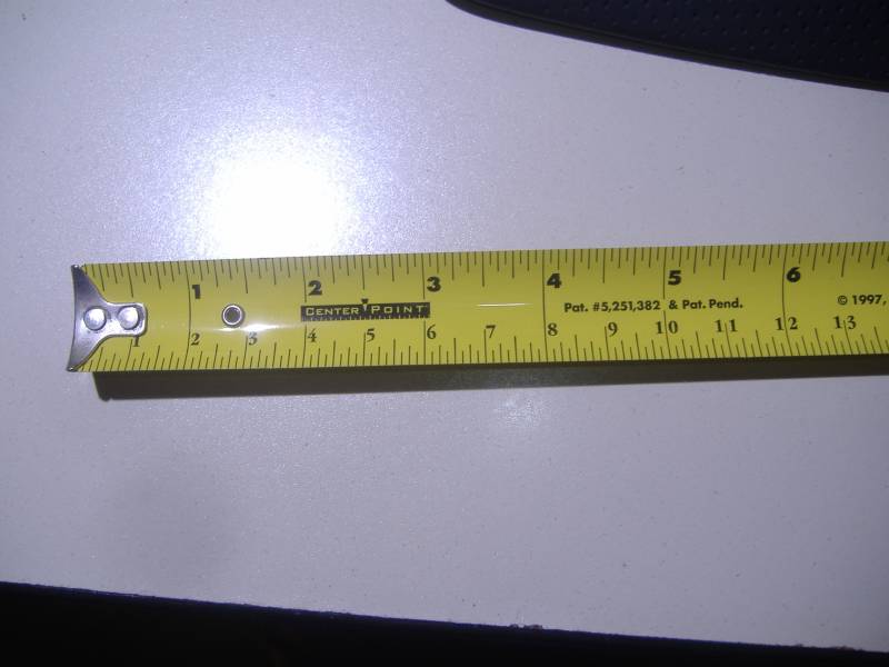

In addition to my 12" and 18" center finding rules I have a tape measure that is good for up to 25'.
[ATTACH]19692[/ATTACH]
[ATTACH]19693[/ATTACH]

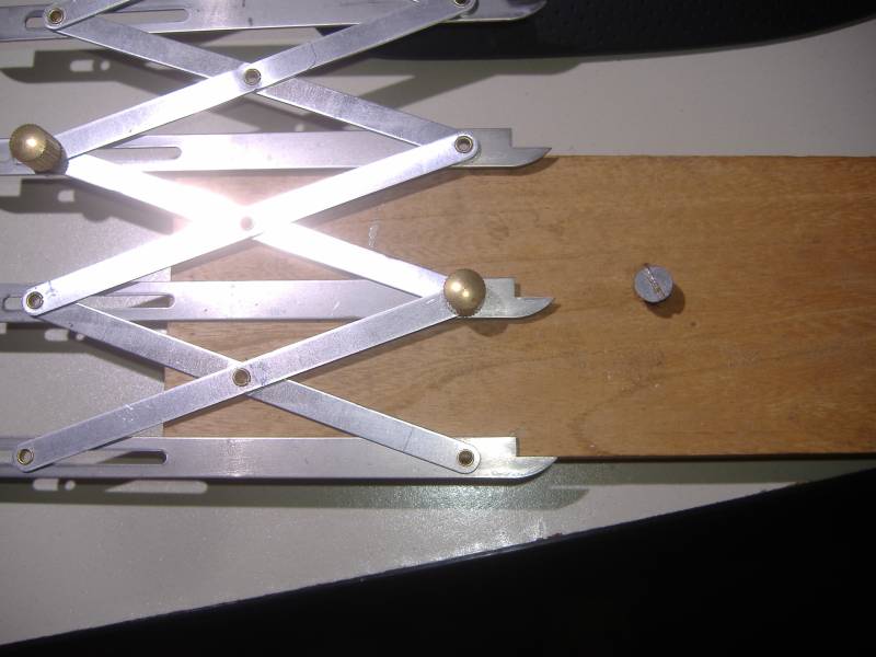

If you have a point-2-point it will also work to find a center.
[ATTACH]19694[/ATTACH]

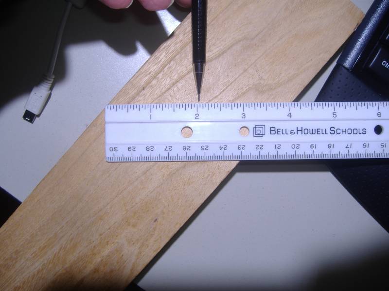

And then you can always use a ruler like shown. In this case the zero is on one edge and the 4" mark is on the other edge, the center will be at 2"....
[ATTACH]19695[/ATTACH]

I had forgot about this one.reible wrote: And then you can always use a ruler like shown. In this case the zero is on one edge and the 4" mark is on the other edge, the center will be at 2"....
