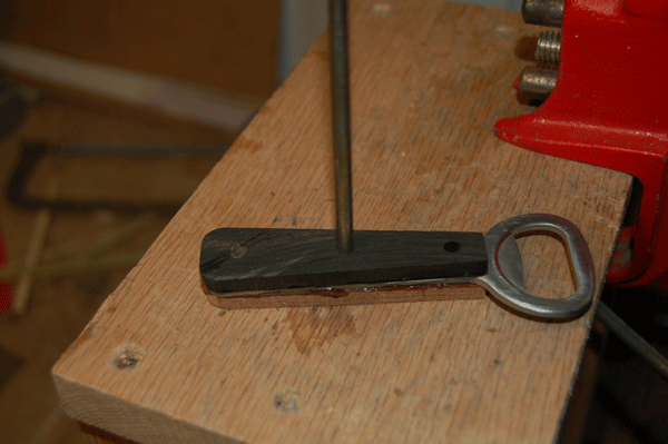

Happy New Year! Thanks for the comments, I signed up for the Yahoo group but I haven't had a chance to visit yet. Here's some pics of work in progress:

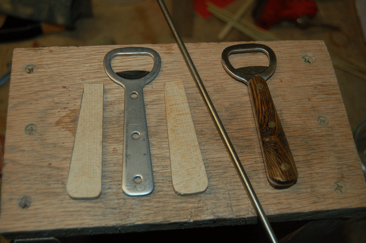

Shape the "scales" to approximate finished size
[ATTACH]19772[/ATTACH]

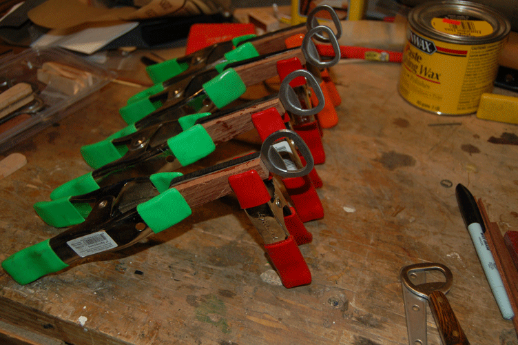

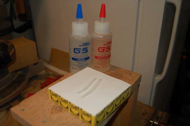

Glue one scale to the opener blank, I use two part epoxy
[ATTACH]19770[/ATTACH]
I like to do a bunch at a time because of the set up of the SS issue
[ATTACH]19771[/ATTACH]
Drill through the blank & the first scale, then glue on the second scale. Drill through the first holes into the second scale, then pound in the pins. I'm using 3/16 nickel silver or brass
[ATTACH]19773[/ATTACH]

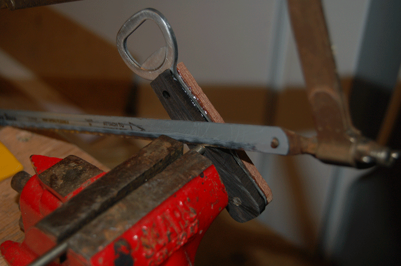

Saw off the pin and start shaping and sanding
[ATTACH]19774[/ATTACH]

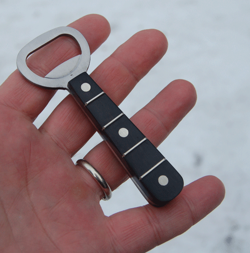

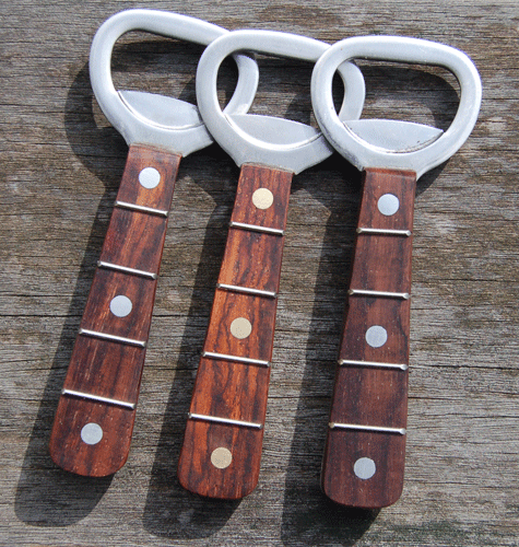

These are probably the coolest bottle openers I have ever seen!Fun King wrote:The ones I am working on are ebony on one side and mahogany on the other. The pins don't go all the way through. They will be embellished with mandolin frets, and come out like this:
[ATTACH]19775[/ATTACH]
These are rosewood

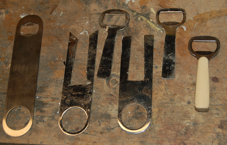

Way cool! Where do you get he blanks?
Abraham Lincoln
Abraham Lincoln
When I started I was trying to recreate a favorite opener that I lost. I was cutting and grinding blanks from "Speed Openers" I bought on-line. But this was tedious and expensive in metal cutting blades. I finally had the blanks manufactured to my specs out of 0.10" thick stainless.
[ATTACH]19793[/ATTACH]
