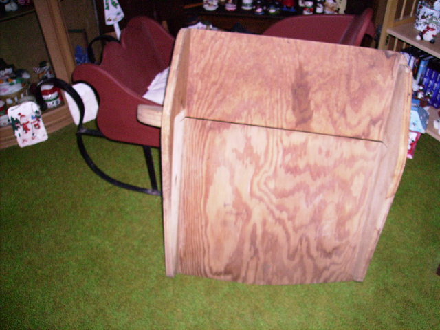

On one I built The most important guarding to me was covering the blade where it became exposed behind the rear cross fence as the sled was finishing the cut. :eek: I had that saw built into a large table and had cut square ended stopped dado's cut out into the big table to allow the miter gauge bar a place to travel. I made the sled so that it used the ends of those dado's to stop its travel at the proper point. Then I made an about a quarter circle guard that attached to the back of the cross fence. It worked very well. I thought about putting a plexi-glass top on it but never did nor did I feel a need to.
Here is a picture of it sitting up on what would be the right end. at the left is the blade cover.
[ATTACH]19938[/ATTACH]
Crosscut sled.JPG (87.42 KiB) Viewed 3111 times
