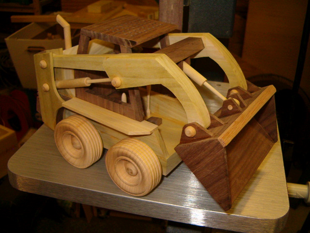

I used the Shopsmith drill press vice to successfully drill holes in dowels. I know you have one of these vices. http://www.shopsmith.com/ownersite/catalog/sa_combinationvise.htm The vice has cute little recesses to hold a dowel vertical or horizontal.
In this toy skid loader project, it was 1/8" holes drilled through 1/4" dowels to make the "hydraulic cylinders". Worked easily with the vice.

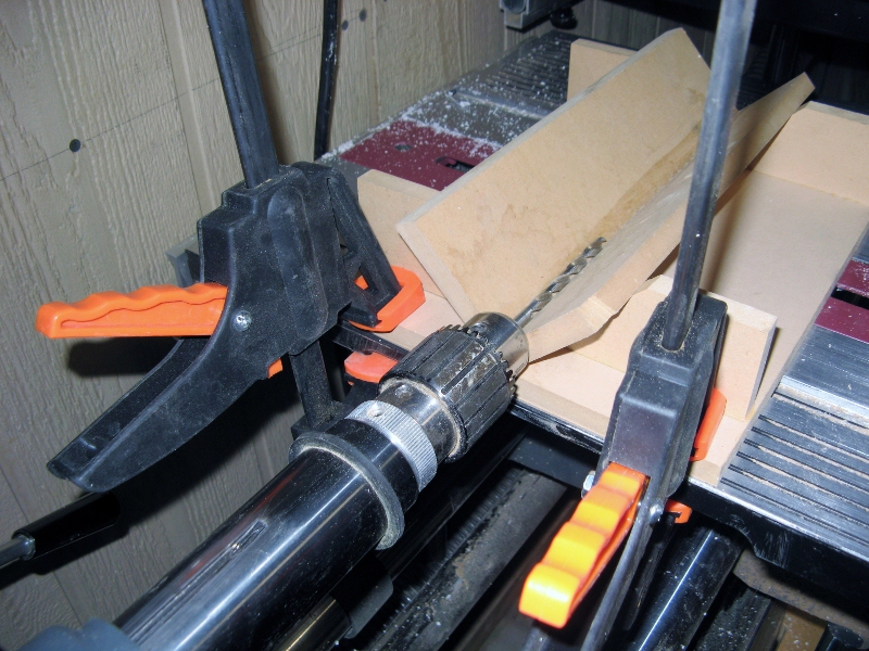

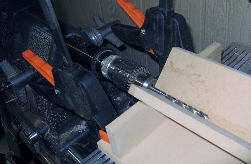

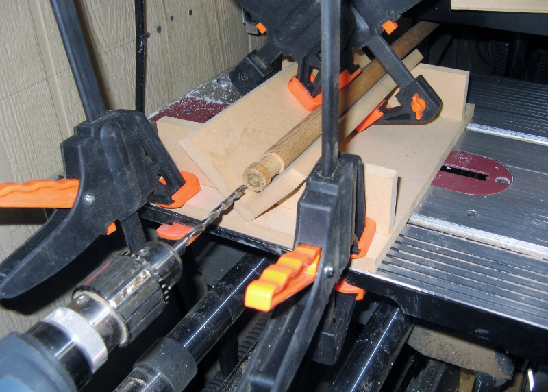

[quote="dusty"]
I am attempting to drill a 1/4 through hole in a 5" long 1" dowel. Drilling the hole is not the problem]
This is how I approached the problem
With the SS in the horizontal position I extended the quill and adjusted the horizontal drilling jig (as close as possible) until the drill bit lay parallel in the bottom of the jig. After clamping the jig in place Lowered the table to place the point of the drill in the center of the dowel and drilled away. Seemed to work OK for me.
[ATTACH]20241[/ATTACH]
[ATTACH]20242[/ATTACH]
[ATTACH]20243[/ATTACH]
Note: The jig is made from glued MDF only no metal attachments

Glenn

Beautiful job, Charlese. Big furniture, little toys - all excellent. You are a CRAFTSMAN.charlese wrote:I used the Shopsmith drill press vice to successfully drill holes in dowels. I know you have one of these vices. http://www.shopsmith.com/ownersite/catalog/sa_combinationvise.htm The vice has cute little recesses to hold a dowel vertical or horizontal.
