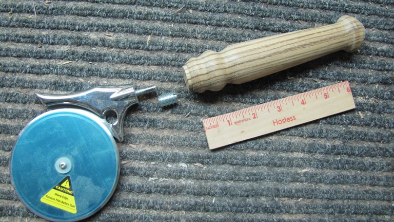

Pix of said pizza cutter handle. I have no vise, or wood clamps. I like the horizontal bore idea, just need to hold it tight and keep it level.
I also only have standard SS tooling and chucks ect.
[ATTACH]20500[/ATTACH]

Hole drilled. Vert bore, brad point bit, upside down scrap of hard wood flooring with grooves-for a cradle, handheld clamping with a soft rag.
If I were to do this before turning the project, it would interfere with my drive center. ?
Next issue, whats the trick for screwing in the insert?? I have 3400 screw drivers and none span the slot well or are too thick for the slot. I was thinking, just screw it in, it will tap its own threads. Hmm, crooked and crazy and very hard to screw in. This pizza cutter kit is way smarter than me.

The internet is a great tool. It appears this is a common problem with the pizza cutter kit as per Rockler customer reviews.
I found a 15/32 drill bit and put a glove on and turned it by hand to bore the hole out. I went up 1/8 from where I started in a couple of steps. Then rounded out the lip of the hole just a tad. Barely started the insert, then threaded in the pizza cutterhead until it was flush with the insert. Then used the whole assembley to screw in the insert. Tight fit.
I guess its pretty common to split the wood from not drilling the hole larger.
I'm still a mow-ron...but a mow-ron with a pizza cutter! :D
R Hart
