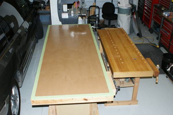

I had one of the Sjoberg's workbenches and consider it too light. Any time I did any heavy work on it, it scooted across the floor. Weight is a good ally in a workbench. I have one that I built using plans from The TV show Woodsmith Shop that has four thicknesses of MDF for the top and straight grain souther yellow pine for the frame. Heavyyyy!!! But it won't move when I lean on it hard.
[ATTACH]20551[/ATTACH]
The photo shows the new bench and the old Sjoberg's bench. The new one has more that twice the work area of the old one.
Bill V
P.S. To answer a question; yes the Sjoberg's bench is only thick around the edges. The center section is only about 3/4 inch thick. Nice hobby bench but definitely NOT heavy duty. JMHO.

BOOM!
Thank You wa2crk!
Though I might not want to have a bench quite as large as your new one the weight issue did concern me. Thanks especially for answering the question regarding the thickness of the top. 3/4" is a lot thinner compared to the one I planned to build.
That said, if the seller ever gets back to me, I might still pick up the Sjoberg. For the price it could still serve as a useful work and tool surface.
Thanks again for your help.
