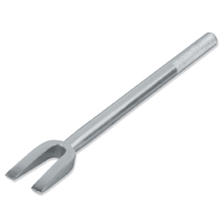

Another prying option would be a tie rod separator
[ATTACH]20582[/ATTACH]
Just make sure the one you use will clear the spindle. Most will.
