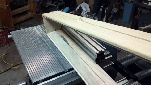

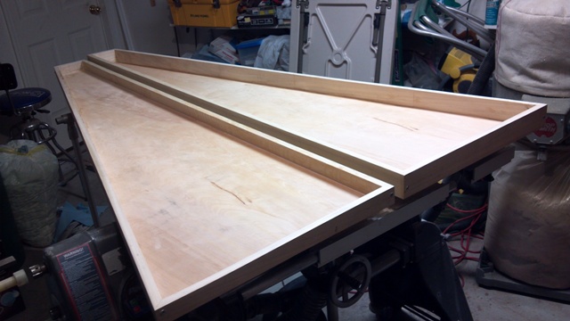

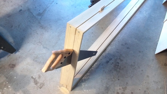

Well I made a decision, and I went with using the table saw for the long sides and hand saw for the short sides. I started out using the sabre saw but it was taking too long. I had no issues with the table saw. Just took my time and went slow.
[ATTACH]20744[/ATTACH]
[ATTACH]20745[/ATTACH]
[ATTACH]20746[/ATTACH]

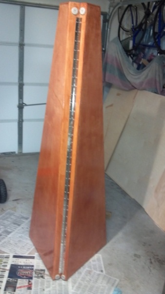

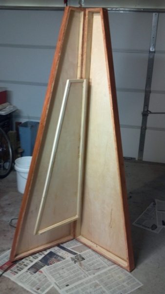

Finished except for the handle and locking lever. This is the type of project I had in mind when I decided to get a Shopsmith in the first place. This being only the third woodworking project I have ever attempted I have come to realize how much I lack in experience. But I'm having fun learning thru trial and error, (Lots of errors), and researching the archives on this site.
[ATTACH]20793[/ATTACH]
Two sections hinged together.
[ATTACH]20795[/ATTACH]
Three sets of remote controlled sailboat rigs and sails will be stored in this transporter. The smaller of the 3 will be stored in the swinging center section.
