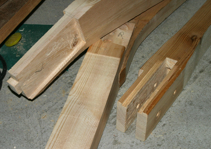

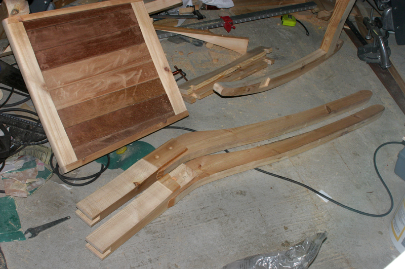

I have made some progress though - I used experimentation to establish a balance position on the rockers & I'm quietly confident it will work. I cut the joints into the rockers & the base of the legs to form a "saddle" to lock the legs in position & minimize any risk of the rockers de-laminating.
The tops of the rear legs were then cut to accept the side sections which also had to be cut to slot into the legs. I'm happy with the result
Joint cut visible and one leg assembled:
[ATTACH]21431[/ATTACH]
The legs were freehand cut to shape on the bandsaw so they look a bit rough here. They look much better after lots of sanding!
The finished pair (still not sanded):
[ATTACH]21435[/ATTACH]

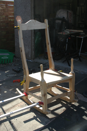

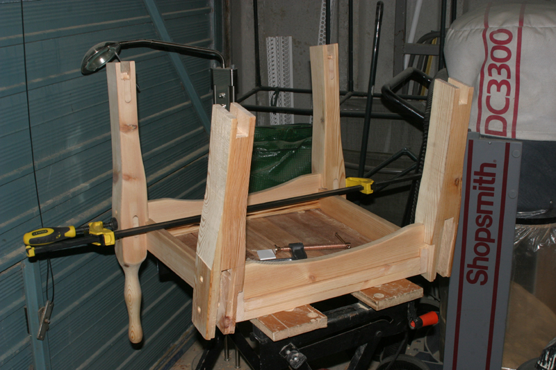

So with all those joints cut I re-assembled and it does now sit much better
[ATTACH]21432[/ATTACH][ATTACH]21433[/ATTACH]
Only the seat section is glued up so far but with all the angles established I was then able to cut the joints for the seat lower crossmembers to fit into the legs. The seat & leg assembly is now sitting upside down on my Workmate and the next move will be fitting the rockers onto that, clamping it all tight and measuring for the lower stretchers. I have plans for those that include carving - never tried that before but then I've never tried to build a chair before either!

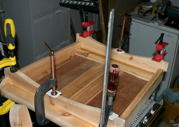

My somewhat loose joints led to the first bad setback I've had - the glued up seat assembly didn't survive the rigors of test assembling the full chair & began to flex. That was the result of badly cut joints with significant gaps between the elements & my use of PVA glue (white glue?)
So, realizing that I needed something more substantial I made my way to my nearest wood turning/hobby retailer. Seeking the owner's wisdom & finding that to be in line with the collected wisdom of this forum I made my way home with a bottle of Titebond II & a smaller bottle of Gorilla Glue. The attraction of the Gorilla Glue being that it foams to fill small voids - and boy, do my joints have some voids to fill!
Well, the Gorilla Glue did the job and I was able to use the Titebond on the better joints for the crossmembers:
[ATTACH]21621[/ATTACH]

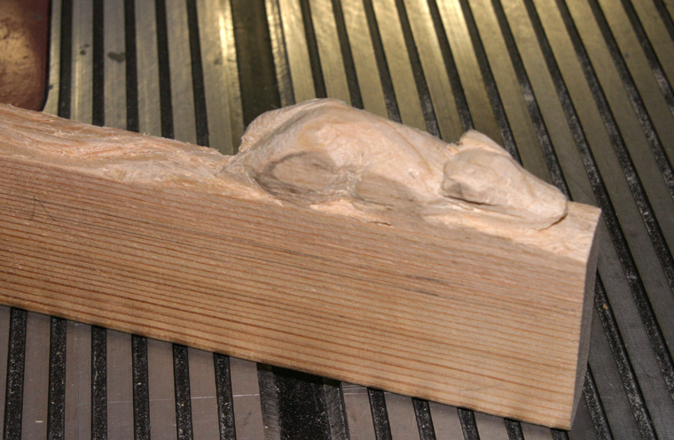

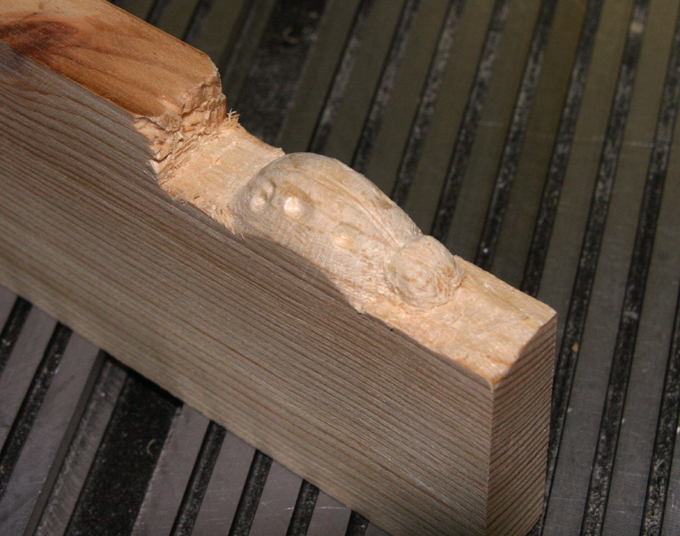

I mentioned carving in my last post and these are the prototypes of what are on the stretchers:
[ATTACH]21622[/ATTACH] [ATTACH]21623[/ATTACH]
The ladybird (ladybug to the majority) was inspired by a little plastic one that had been stuck to the bunk bed - probably no. 2 daughter again, she does like sticking things - and I thought it might be cool to add something similar. The mouse recalls a story my father once told me about a woodworker who used a mouse as his trademark, carving one into furniture & Church fixtures that he made. I just Googled that & came up with Robert (Mouseman) Thompson for those who may be interested. That story intrigued me at the age of about 9 so this is just a nod to that.
Anyway, I had never carved anything before so I'm rather pleased, and surprised, with the results

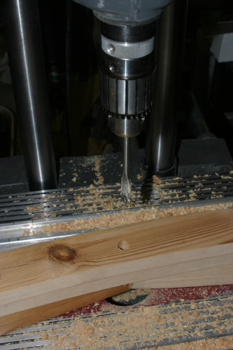

So what progress? Well, I got all the holes for the dowels cut while all the faces were square
[ATTACH]21809[/ATTACH]

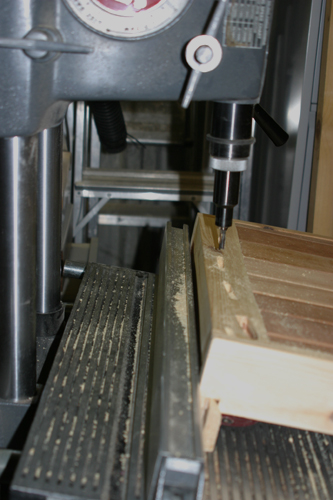

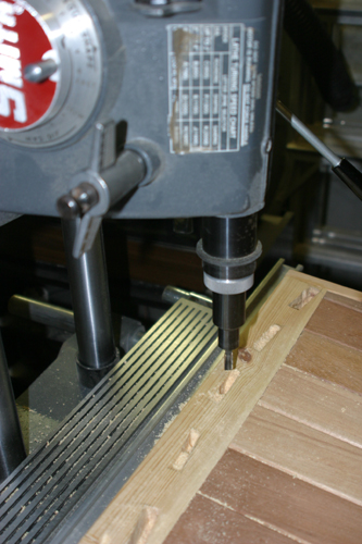

While the glue was drying I used the SS router function in drill press mode to slot the seat assembly for the back slats:
[ATTACH]21811[/ATTACH] [ATTACH]21810[/ATTACH]

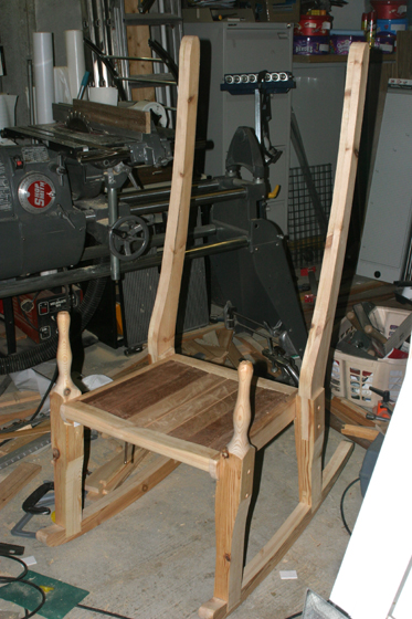

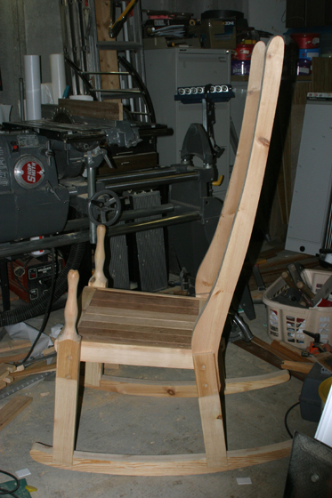

Yet another dry assembly followed to get the angle for the top piece and the lengths for the slats. I know this should all be coming off my drawings but my drafting abilities don't run to compound angle dimension calculations:(. Dry assembly & a tape measure works for me!
[ATTACH]21807[/ATTACH]

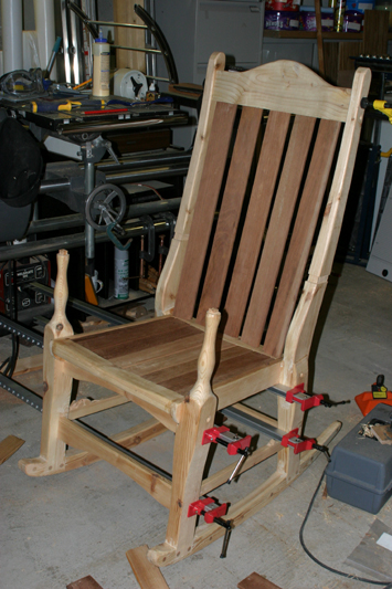

with my new measurements I routed the slots in the top crossmember (did I mention I shaped that to give a curve in plan view to match the slat layout and I also made a curved cut in front elevation view for decorative effect. Those combined curves made mounting on the SS (in horizontal boring mode) somewhat ... challenging
. I also got the first slat cut and then assembled it all again to check:
[ATTACH]21806[/ATTACH]

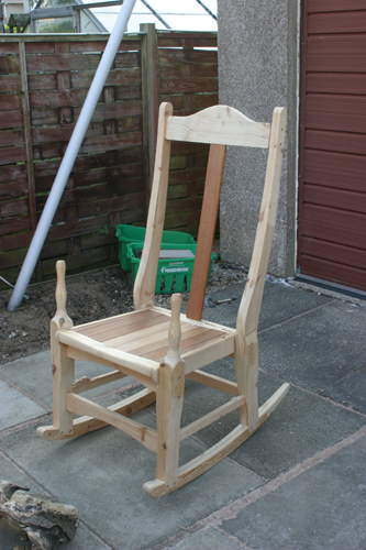

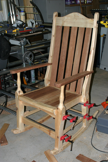

It all held together without the aid of a clamp & I was able to sit in it & rock - very comfortable
It all worked well so I've now got the rest of the slats cut. A bit of sanding & maybe a bit more chiseling & it will all fit together pretty well.
That will leave only the arm-rests to cut & assemble to have all the component cutting completed. I've still to cut & fit the dowels; after that is done I'll finish the shaping work - surform & 60grit paper is doing the trick.
The plan is to finish all the shaping & then glue up the whole thing and finish sand. Finished for next weekend? Probably not

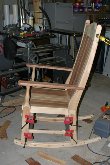

A little bit of table tilt added to the slope of the seat gave the correct angle for the slats:

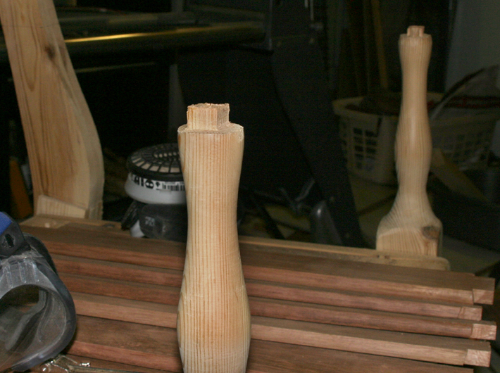

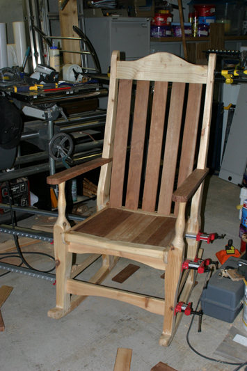

Arm rests: the final pre-assembly components! I originally intended to make these from the pine boards but I didn't have quite enough left
So the bed slats were put to further use. They are some kind of dark red hard wood - one of the mahogany look-a-likes but not that hard &, I would expect from their original purpose, a fairly cheap product!
However, they are serving me well in this project & the color is not unpleasant - a good match for the mahogany dowels in fact!

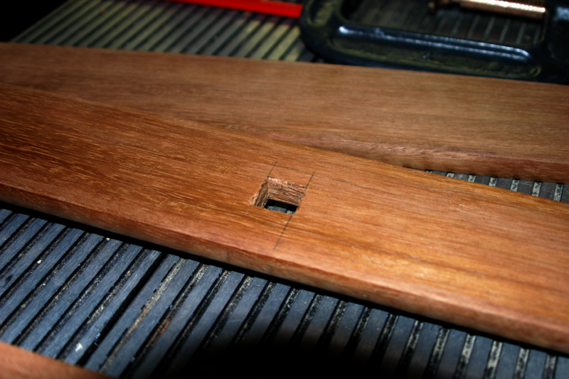

To form the arm rests I started by cutting a square peg into the armrest supports:
[ATTACH]21887[/ATTACH]
Then I cut a hole into the lower section of each armrest to fit onto that
[ATTACH]21886[/ATTACH]

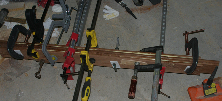

before laminating 2 slats per side to get a decent thickness:
[ATTACH]21885[/ATTACH]
After the glue had set I planed , shaped & sanded.
I had been hunting for a spoke shave to round the edges & just couldn't find one locally. I finally came across one in a local branch of a national DIY chain - the last place I would have expected to find that because their DIY has a focus on home furnishings, gardening, paint etc with a few tools thrown in for good measure; a spoke shave seemed a bit too specialized for them. So I now have a decent spoke shave and what a pleasure it is to round edges off with it - quite addictive actually so I better be careful not to round something that should be left square
:eek:

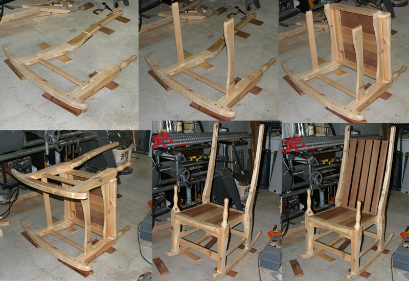

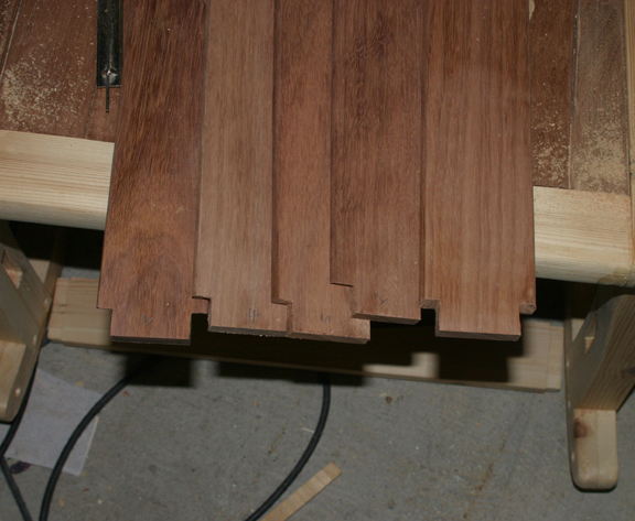

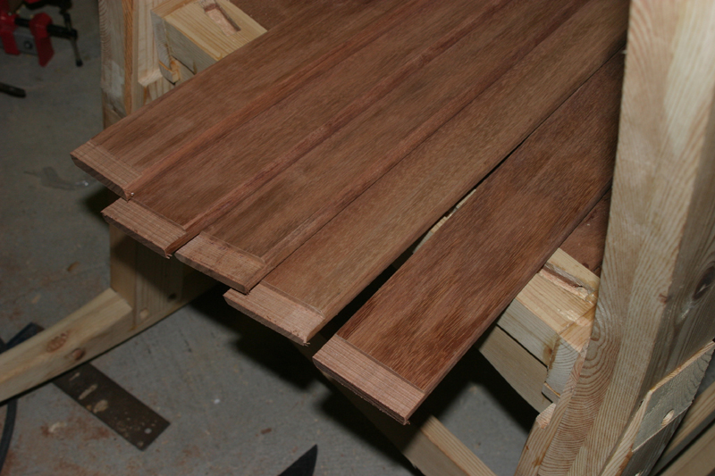

The slats to form the chair back are now all cut, as are the receiving holes in the seat and in the top crossmember. The slats will be loose in the structure to allow for flexing under load.
Base of slats:
[ATTACH]21888[/ATTACH]
and top of slats with, showing at either side, the slots cut into the seat for the base of the slats to fit into. You can perhaps see that the slats will form a curve.
[ATTACH]21889[/ATTACH]
Base of slats:

Dry run
Well, I managed to do the dry assembly quicker than I expected so you get 2 posts in the one day - although, technically, being in Scotland I'm now into the next day.
So before packing up for the night I did this (not sure how much detail will show in the big pic - I'm cheating so that I fit 10 pix into the 5 allowed on a post
Progress shots through the dry assembly:
[ATTACH]21891[/ATTACH]
[ATTACH]21892[/ATTACH]
and some different angle views to give an idea of what it will look like:
[ATTACH]21893[/ATTACH][ATTACH]21894[/ATTACH][ATTACH]21895[/ATTACH]
Next step - the same exercise but with ... GLUE
