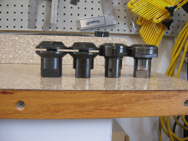

pictures of 500 arbors and 510-520 arbors
Will attach so people can see the difference. the 510-520 arbors are the two of the right 500 the two on left.[ATTACH]21950[/ATTACH]
- IMG_3031.JPG (88.75 KiB) Viewed 3912 times
saw arbors
