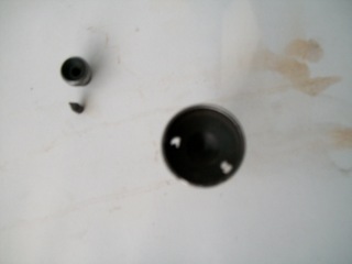

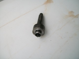

billmayo wrote:Do anyone have a way to replace the bearing in the live center? I have one that the bearing is really rough. I did not see any way or believe I have any tools to help remove this bearing. Not many things gives me this kind of problem. I had thought of drilling a hole(s) on the back side to punch out the bearing.
Good idea. I used a 3/16" drill bit to drill 2 holes opposite each other in the back side of the head. I used a pin punch to remove te bearing. The replacement bearing was a 32mm X 12mm X 10mm shielded bearing.

billmayo wrote:Good idea. I used a 3/16" drill bit to drill 2 holes opposite each other in the back side of the head. I used a pin punch to remove te bearing. The replacement bearing was a 32mm X 12mm X 10mm shielded bearing.

Wise thinking o' great master! :cool:
I shall follow thee!:)
May drill three 9/64" holes and walk the punch around.:rolleyes:
