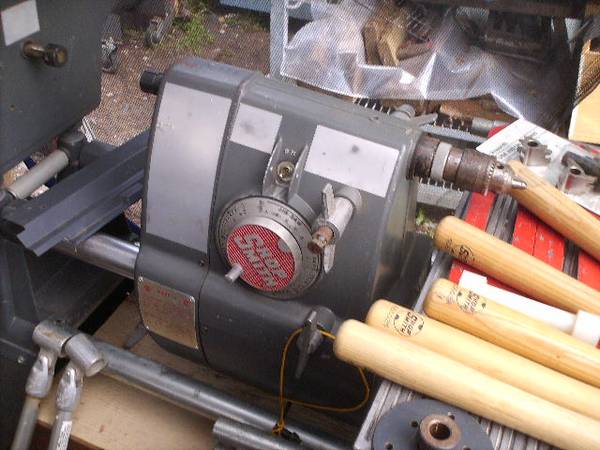

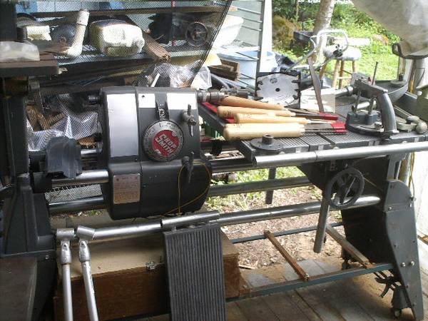

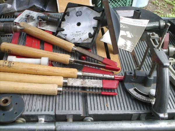

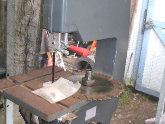

Here is what will be included:
(i will attach pics but not all is shown)
Shopsmith (510 with all tables and telescoping legs)
-Standard attachments and accessories (minus the drive spur for the lathe -does that cost much? & no brad point bits for drill press)
-Drum Sander
-Shaper Mandrel w/ stile & rail bit set
-Router attachment and bits
-Bandsaw with 4 different blade sizes
-Jointer (the newer model w/ featherboard guard - has some surface rust but zero pitting and knives are in great shape)
-Set of 12 forstner bits
He has agreed to my offer of $400.
