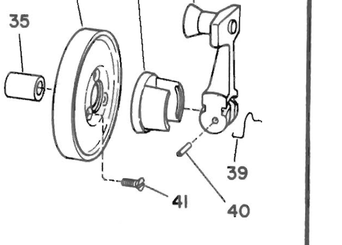

An off the wall question.
Behind the 'traverse crank' / 'headstock lock', is a weirdly shaped wire spring that AIUI helps keep the crank captive in the 'closed' position. I do not have one of those. Any chance you could take pix of it in various positions of the crank so that I might be able to reproduce one? Of particular importance is the ends where it attaches to the hub(or crank) and how it works(spring shape as it slides on/off the crank). I believe the crank has a sloped ledge that the spring 'grabs'.
#39

The little spring deal. I took a couple shots. If we need more info we can pull it out. Looks pretty basic. I'm not even sure of what role it is playing. On to the pics. One from each side/handle flipped.
[img][IMG]http://i1315.photobucket.com/albums/t593/squashfest81/IMAG0790_zps6488dfc7.jpg[/img][/IMG]
Thank You for the spring pix.
Do I understand correctly that the spring passes through the hole in the shaft?
Also that the spring is essentially "S" shaped?
Although in the pix it appears to have it's ends in a hole, there are no holes in mine so do I understand correctly that the ends of the spring merely press against the inside edge of the hub?
I would have never guessed that from the parts diagram.
Function wise, I think anti-rattle in the transverse crank position, and detent/anti-rattle in the locked position.

[quote="JPG40504"]Thank You for the spring pix.
Not a problem. More if we need them.
Yes, passes through the hole.
Yes. I'd say absolutely S shaped.
The spring ends are not in holes. I actually grabbed them with pliers as I assumed they would be. Spring is bent in the S and the ends just end and happen to sit where they sit.
I agree.
Anti-rattle makes sense.
I agree.
