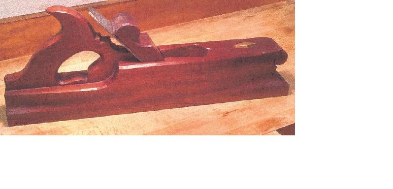

Thanks 'JPG' I missed your #5 post final line. You are absolutely correct on jointers being designed for edge work. I get the hebby-jeeves just thinking about planning a board on a jointer. I understand the younger woodworker not knowing about hand planes, as I didn't learn about them in woodshop class, and didn't learn until I starting working with my father's (Craftsman - made by Stanley) #5 back in the '80's. I still use Dad's plane, but love a Casimiro Sousa & Sons #5 plane that is made of Mahogany with a Teak bottom. It glides over the the surface effortlessly, a real joy to use. I did a Google search for Casimiro Sousa and did not come up with this plane being manufactured any longer. I bought it from Garrett Wade about ten years ago.

Post by WmZiggy »
[ATTACH]22285[/ATTACH]
I thought I would send a pic of the Casimiro Jack Plane.

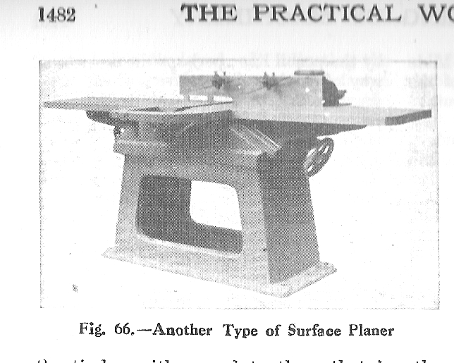

So what do WE know!:D
I found this pix in my just arrived 4 volume 'Practical Woodworker' reprint(original 1916 vintage) from Popular Woodworking(Thank You Megan!!!!). Dated, but practical and gorgeous!
[ATTACH]22290[/ATTACH]
Says nothing about edges!:eek:

I know how you feel as I checked the chapter in the old PTWFE by DeCristoforo and there is more than enough on surfacing boards on the SS Jointer. Still, there is a reason they make planers with rollers on top and bottom - safety perhaps! Even DeCristoforo says one's hands should never cross over the blades on top of the board. Looking at the picture you posted, that jointer is a beast. Looks like specialized hold down equipment on the fence. Still, if I am flattening cupped boards I prefer hand planes, then my SS planer.
