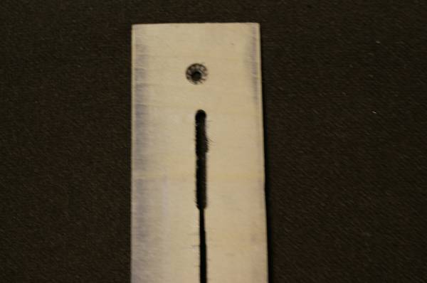

I know that there are lots of threads about ZCI's but Dusty what method did you use to increase the length of the slot so that there was room to attach the splitter?

I read your inquiry to Dusty about the ZCI and I extended the slot in mine on the router table and lowering the ZCI over the 1/4" bit to extend the slot.
[ATTACH]23899[/ATTACH]
Bill V
plywood ZCI.jpg (71.7 KiB) Viewed 3277 times
