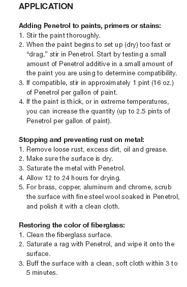

BuckeyeDennis wrote:My shop environment is a lot less challenging than yours, but I have had problems with rust re-forming after using Evaporust to restore vintage tools. I subsequently stumbled upon a two-step process that so far has been 100% effective at preventing rust from re-forming.
Step #1 is to apply Penetrol liberally, following Evaporust treatment and subsequent buffing/polishing down to bright metal. Left alone, the Penetrol will stay tacky for days, and then eventually dry hard and freeze up any moving parts. But it really does seem to penetrate as claimed down into any pits and grain, and prevent rust from forming down there.
Step #2 is to wipe down the tool with WD40 after a day or two, while the Penetrol is still tacky. It removes the Penetrol from the surface, but apparently leaves it down in the pits and deep grain. I have yet to have any rust reappear after this treatment, even after extensive handling. Treated with WD40 alone, rust starts re-forming within weeks.
My various cast-iron tables are in good shape, and JPW alone has been sufficient to prevent rust. But I see no reason why JPW could not be applied as a third step in the process above, when a clean slippery surface is needed.
Since your post, I've been reading up on the benefits of Penetrol, and they sound quite impressive. It seems that Penetrol has 3 times the penetrating power over water thanks to it's very low surface tension. I think that your 2 step treatment is definitely something I'll give a try.
One question though, what is the product # your quart can? I've seen the number 400, and 405, 410, and 415 on product descriptions. Most are billed as paint enhancers, with 415 being used for oil based paints. That one is $45 a quart! Makes me wonder if that's the highest quality for outdoor durability. Some of the others run around $10-$15 a quart.
Thanks for all your suggestions and solutions!

The only product code that I could find on my can was "FLD4". It is indeed intended for oil-based paints. I bought it at the local HD for about $9, and I think that the local Ace has it as well. Here's a link to the HD product page.

FYI: . . . . . .
[attach]23974[/attach]
penetrol instructions.jpg (98.13 KiB) Viewed 11782 times
