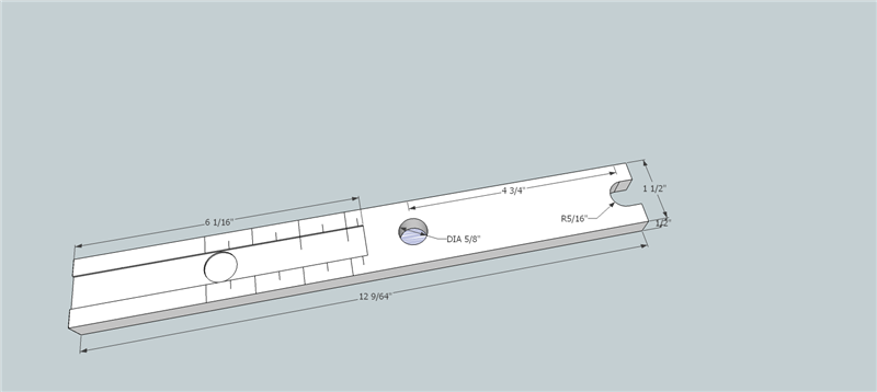

Can someone elaborate on exactly how and where this gauge is used?
pieceseeker wrote:Can someone elaborate on exactly how and where this gauge is used?
When it is done, I will post some pictures and enough instructions to permit anyone who wants to build one do so. I will do this even if I find that it is not a complete success.
For now, suffice to say that the two holes fit the two drive shafts on the left end of the headstock.
[ATTACH]24001[/ATTACH]
REVISED....THIS DOES NOT WORK

Ballpark ETA?dusty wrote:When it is done, I will post some pictures and enough instructions to permit anyone who wants to build one do so. I will do this even if I find that it is not a complete success.
?? Whatcha gonna do when you adjust the poly-v belt tension?;) ??
[quote="JPG40504"]?? Whatcha gonna do when you adjust the poly-v belt tension?]
Fear not! That is NOT an issue for a couple reasons. First - just how often do you adjust poly-v tension. Second - it's covered in the design. See drawing changes.

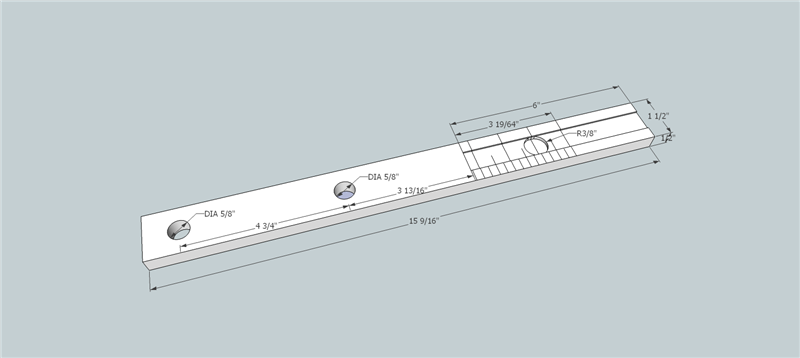

The revision incorporates a 6" steel ruler, held in pace by a magnet. The position of the steel rule allows for "calibration"
[ATTACH]24004[/ATTACH]
Remember that this is dependent upon a laser line. I use a Craftsman 4 in 1 Level (Laser Trac) part number 948247 to provide that.
The final version of this will have the two drive shaft holes enlarged to accommodate the hubs rather than the 5/8" shafts.
But from a different perspective...you could just mark the depth of cut right on the blade and read it direct. SWMBO made that suggestion. Gotta think about that.
