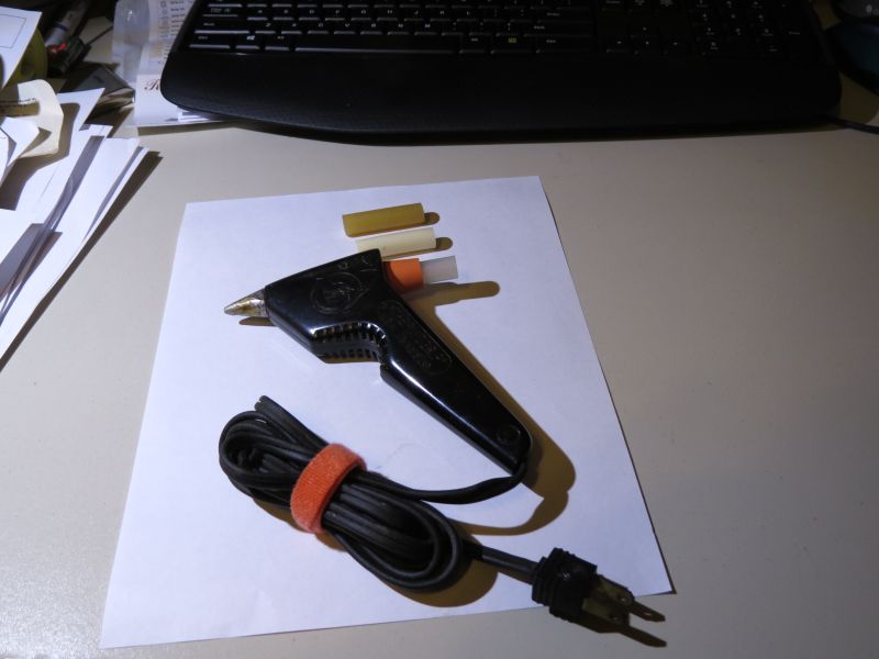

I had just returned from Vietnam and got started using my GI bill for some schooling. We had (wife and I) a small apartment and got moved in. One of the first things to arrive in our mail box was a padded envelope from one of my brothers. Inside was a hot melt glue gun and glue sticks. That would be fall 1971.
I had never seen anything like this, not sure how long they had been around by then??? It was new to my brother as well and he liked his so well he just had to get one for me.
I still have it and still use it from time to time.

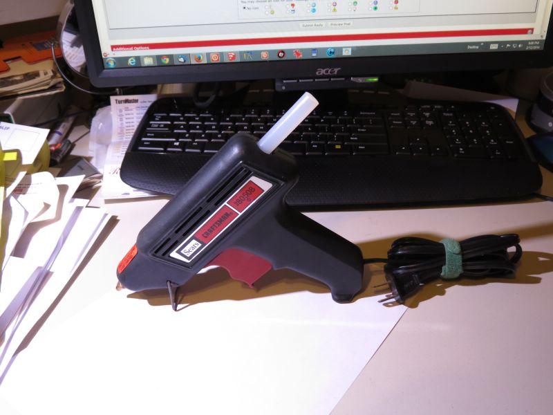

Later models had added a feed mechanism so I had to get one of those, but they were not ready for prime time, at least the model I selected. With in a few months it failed and had to be trashed.
Not to be assumed as all bad they had also went to longer glue sticks by then so a few few few years later I purchased this one.
[ATTACH]24060[/ATTACH]
It still works fine and is my current version. Since this is getting to be an older model I can not speak of what the current versions of these are like.

[ATTACH]24059[/ATTACH]
My first one is exactly like that one. I used it with P-Teks (sp?), to fill the bases of snow skis that found the rocks on the ski slopes. I remember pushing with my thumb and it getting very warm as I got closer to the rubber tube. Also remember the excitement of getting hot melted p-tex on my skin and the exciting accompanying blisters!
