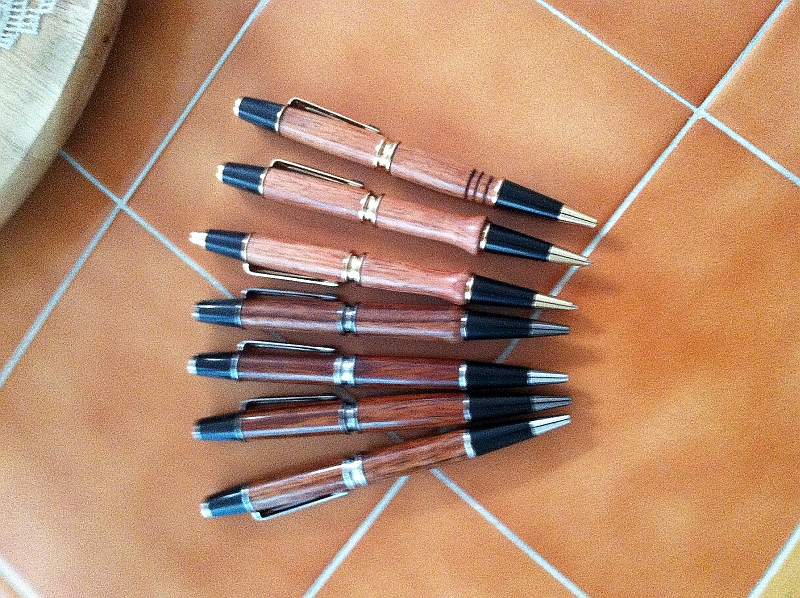

More like what we are used to seeing.
[ATTACH]24603[/ATTACH]
Nice Chuck!!!
Nice Chuck!!!
- chucks pens.jpg (485.7 KiB) Viewed 3960 times

Back to woodworking - making pens
I really hesitate to say the words "turning pens". It's true the wood (or plastic or other) must be turned to make a pen, however I found most of the work involved is preparing a couple wood blocks for turning. There has to be a hole bored through a wood blank and a copper tube inserted and glued in that hole. Then the wood must be shortened, usually sanded, to the exact length of the copper tube. Not mentioned earlier, the wood blank must be a little longer than the copper tube included in a pen kit. Then when shortened, hopefully at right angles to the tube, all extra glue or epoxy will be sanded off.
The supplies my son bought for me had long wood blanks, that when bandsawn, will make three blanks suitable for the pens. Unfortunately, these long blocks already had holes bored through. Some of the holes were not perfectly centered and some actually had ovals. The ovals didn't bother me much because the epoxy filled the gaps between the wood and the copper tube. The real issue with a sloped hole was that sanding a right angle to the wood will find the copper tube to not be at a right angle to the tube. The result is an incomplete mating of the turned wood with the parts of the pen.
Penn State Industries makes a tube reamer with a right angle trimmer for a few bucks. This would be a good tool just in case it's needed. I didn't have one so one of the pens I made is a little crooked.

Chuck- Penn State sells a jig which holds the pen tube square to the sanding disk, rather than the wood square to the disk:
http://www.pennstateind.com/store/pksqu ... odpage=1PK
Gary
Gary
Hmmmmm! A straight rod in the SS miter gauge 'bore' for the miter gauge stop rod would do the same thing.greitz wrote:Chuck- Penn State sells a jig which holds the pen tube square to the sanding disk, rather than the wood square to the disk:
http://www.pennstateind.com/store/pksquare.html?prodpage=1PK
Gary
