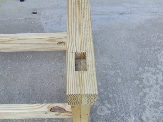

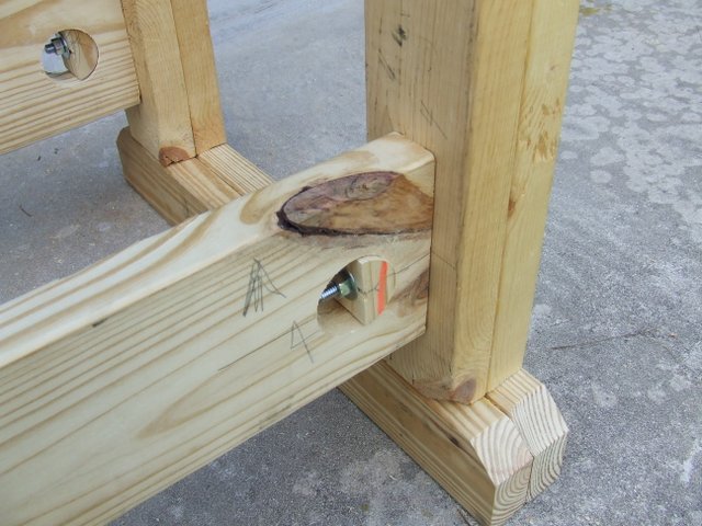

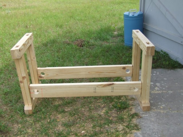

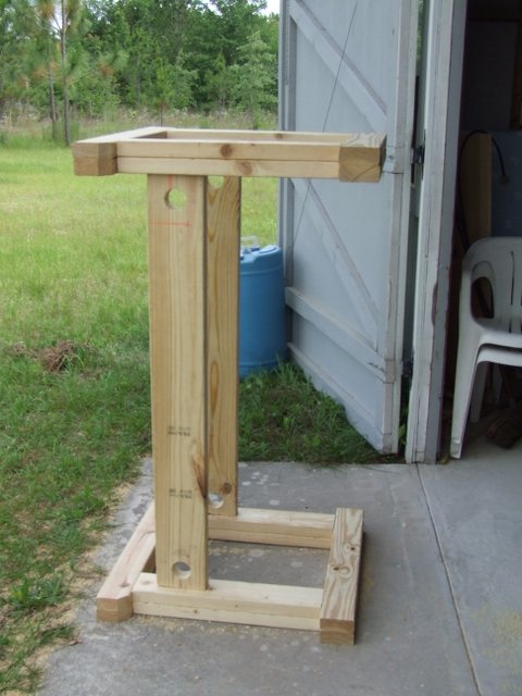

Here is a cheap and simple bench that I built..It's most like a design that I got from and built decades ago from Kitty..
- DSCF5635.JPG (64.04 KiB) Viewed 3839 times
- DSCF5636.JPG (77.74 KiB) Viewed 3822 times
- DSCF5640.JPG (68.08 KiB) Viewed 3817 times
- DSCF5641.JPG (73.88 KiB) Viewed 3826 times
- DSCF5992.JPG (57.55 KiB) Viewed 3829 times

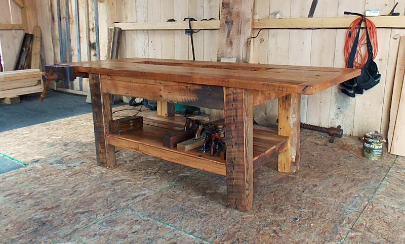

paulsgreenbarn wrote:I made a bench too but no wheels.Added an antique vise bought off *bay.
NICE bench Paul. Looks like it nice and HEAVY too.
