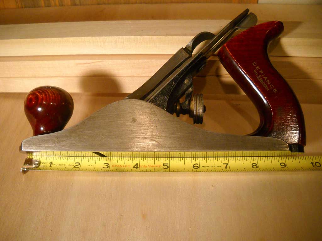

OK, here ya go...Here is a picture of my Stanley Defiance smooth plane. According to Professor Google, Stanley marketed tools in the Defiance line from 1929 to 1953. I suspect this one was made after the war, probably early 50's. I discovered I was wrong calling it a #3...those were 8 inches long...this one is 9 inches long and is properly a #4 From a web site called Patrick's Blood and Gore, I found this little write up about this plane:ibskot wrote:This thread could use some plane pics...just saying....
#4 Smooth plane, 9"L, 2"W, 3 3/4lbs,
"The standard smoothing plane. This, along with the #5, are what made Stanley a fortune. This plane will out-smooth any sanding, scraping, or whatever on most woods. There are woods that present themselves as problems for this plane, and the rest of the Stanley bench planes for that matter, but this shouldn't deter you from owning one. The planes were designed to be general purpose and affordable, not to conquer any wood tossed their way. Many modern woodworkers have their first plane epiphany with this little tool as the curls come spilling out its mouth."
As I said, this is my "go to" plane for most shop tasks other than jointing long edges. I have even used it, set coarse, as a sort of scrub plane and it works pretty well. I have an inexpensive Buck #5 that I am going to regrind the blade to make a true scrub plane out of...one of these days.

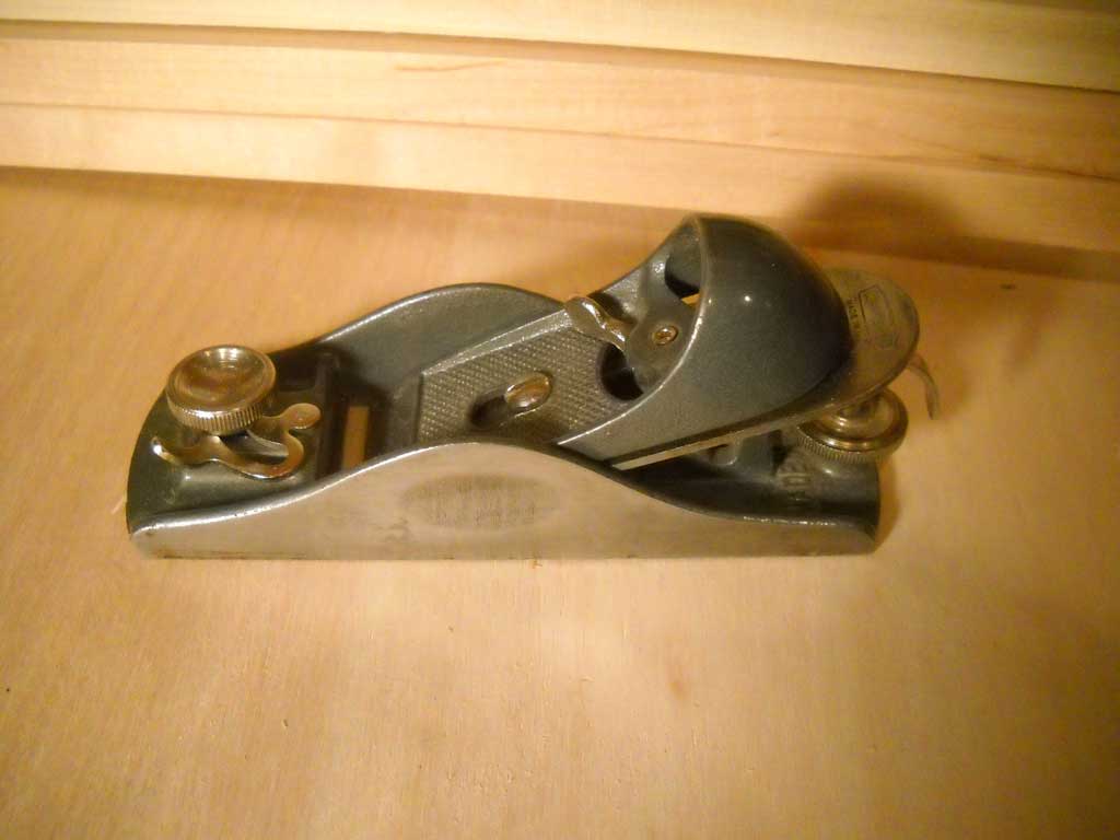

The other plane I use a lot is an old Craftsman block plane. Use it all the time. I have a nice Veritas low angle block plane and I like it too, but for rough and ready work the Craftsman is great.
These are probably the two types of planes I would suggest a new woodworker buy first.

Nice. I have a c'man block just like that. It is the the non low angle block I use.

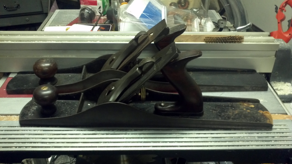

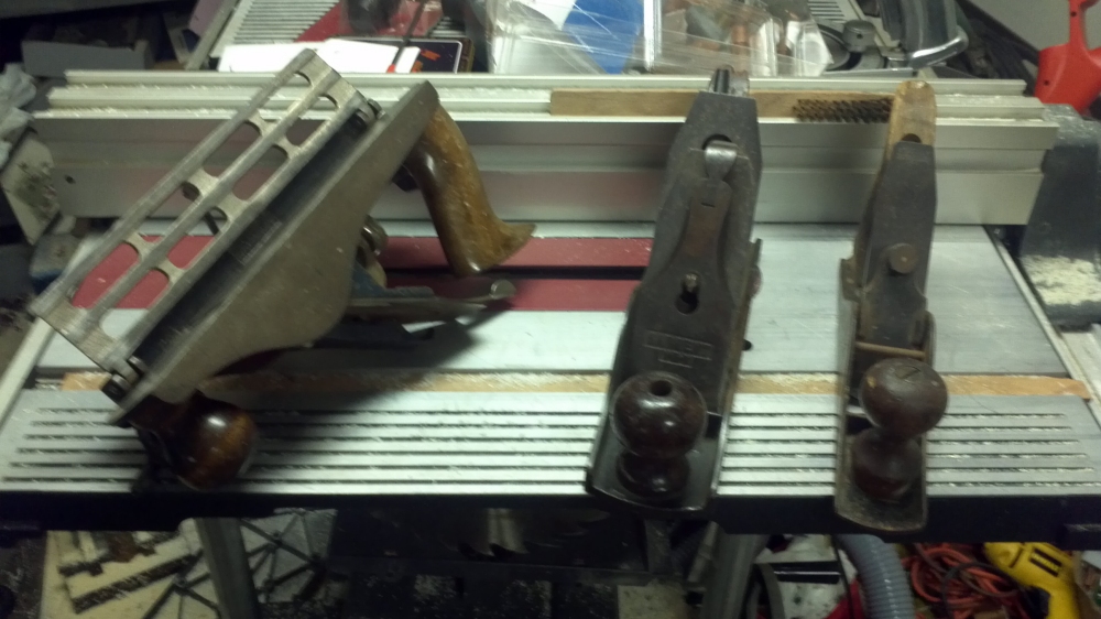

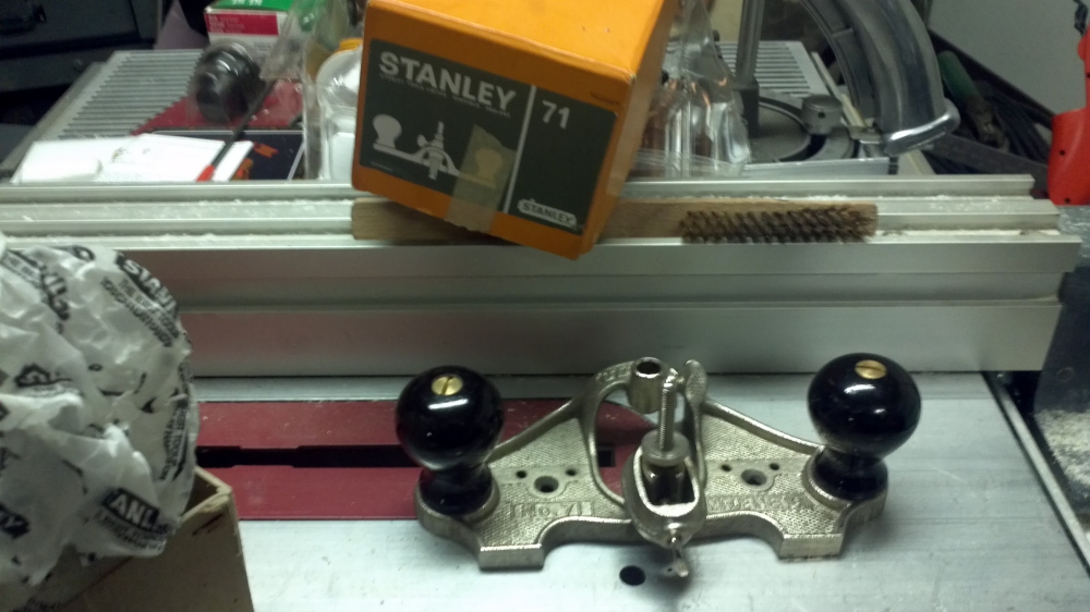

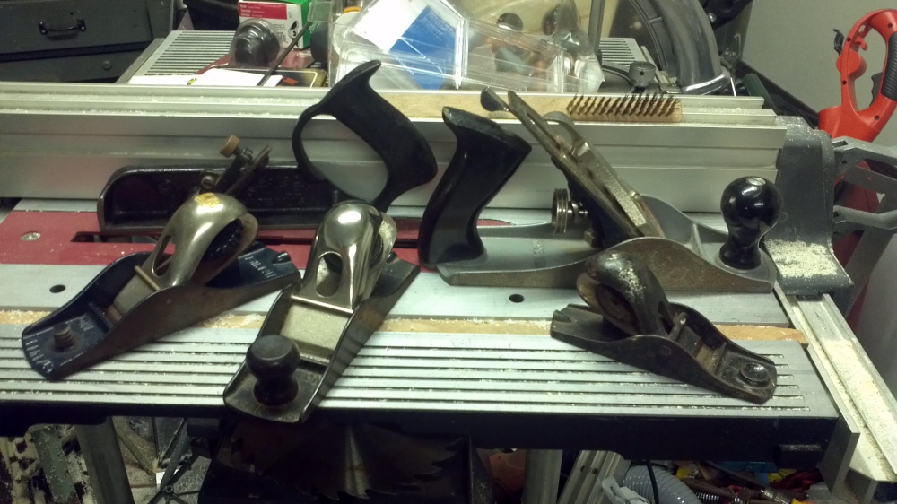

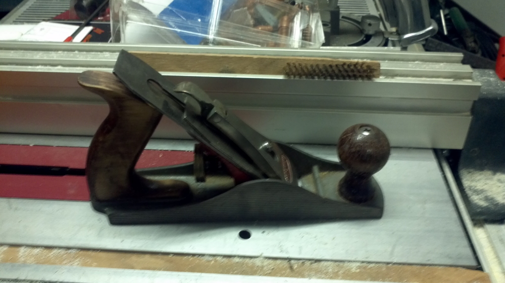

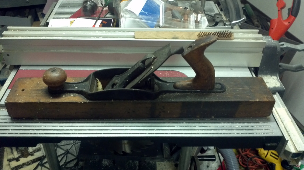

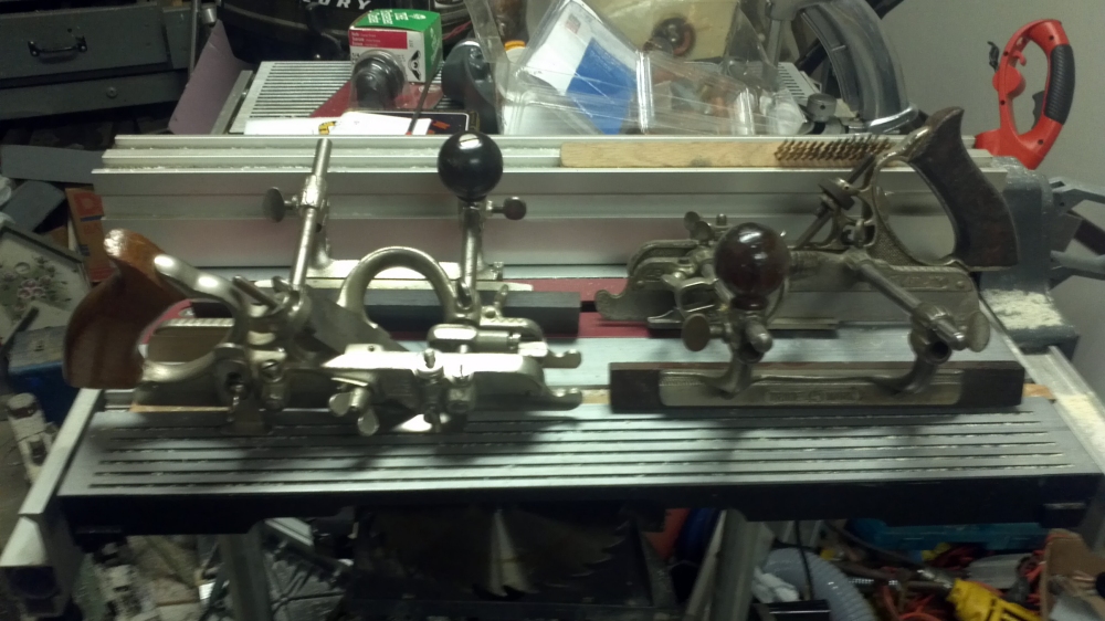

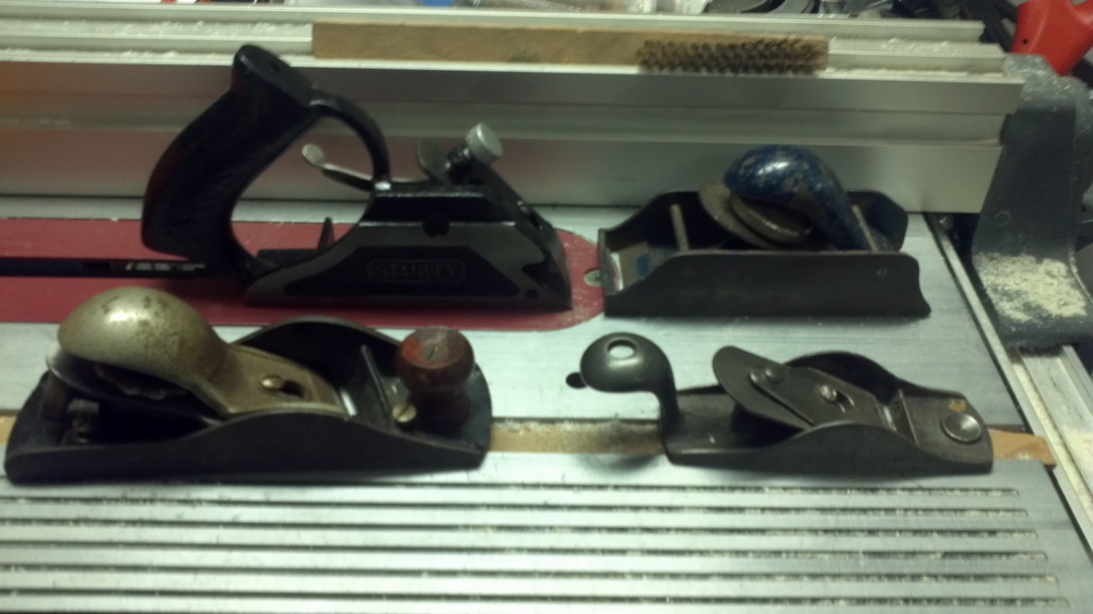

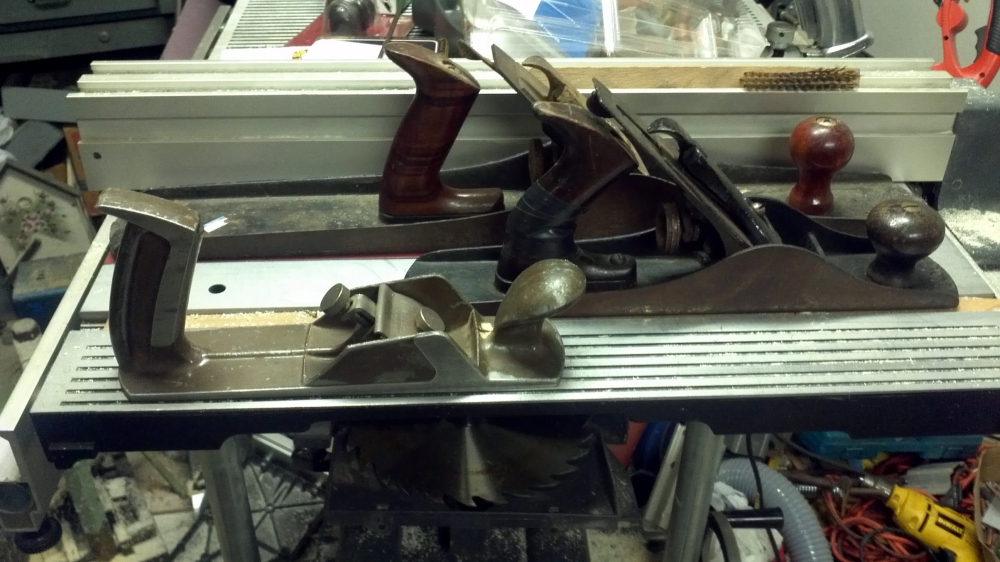

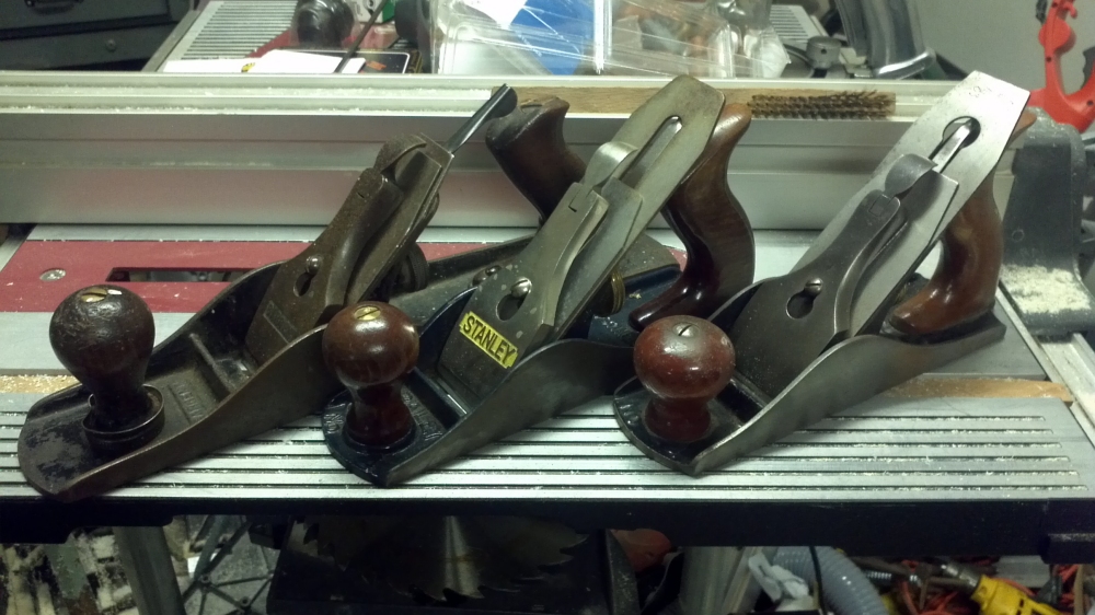

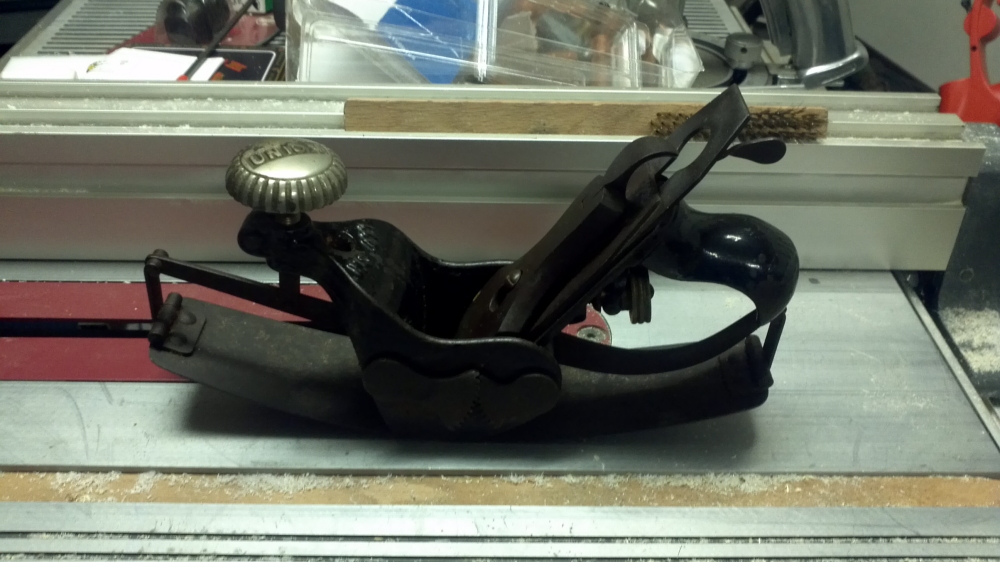

This is about half of what I have collected so faribskot wrote:This thread could use some plane pics...just saying....
[ATTACH]26352[/ATTACH]
[ATTACH]26353[/ATTACH]
[ATTACH]26354[/ATTACH]
[ATTACH]26355[/ATTACH]
[ATTACH]26356[/ATTACH]
- Planes 01.jpg (300.59 KiB) Viewed 4676 times
- Planes 02.jpg (338.23 KiB) Viewed 4678 times
- Planes 03.jpg (290.21 KiB) Viewed 4678 times
- Planes 04.jpg (291.03 KiB) Viewed 4678 times
- Planes 05.jpg (329.02 KiB) Viewed 4678 times

Absolutely outstanding! I don't know, I seem to have a gene for "collecting", don't know if I want to get started in this
It always starts with the first one .....
Nice set of tools ...
