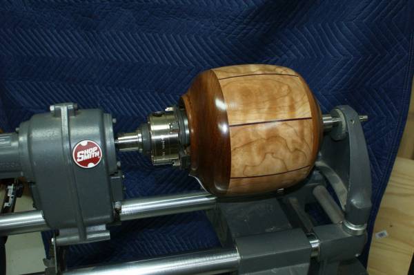

Power Pro plus Speed Reducer = 35 RPM. Good for finishing turnings
Funerary vessel one.jpg (82.29 KiB) Viewed 7218 times
