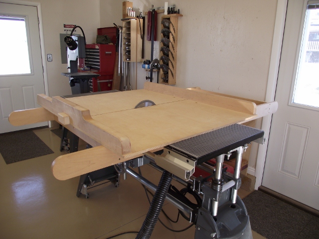

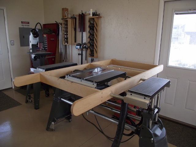

Yes, he has created a way to use a significantly larger cross cut table. Mine accepts a panel up to only 22". His approach resolves an issue that I had and still have. The solution, in addition to a larger table, is support on both the infeed and outfeed sides of the Main Table.
GOOD JOB. It also shows that with some extra effort and some ingenuity, almost all wood working tasks can be dealt with on a Shopsmith.

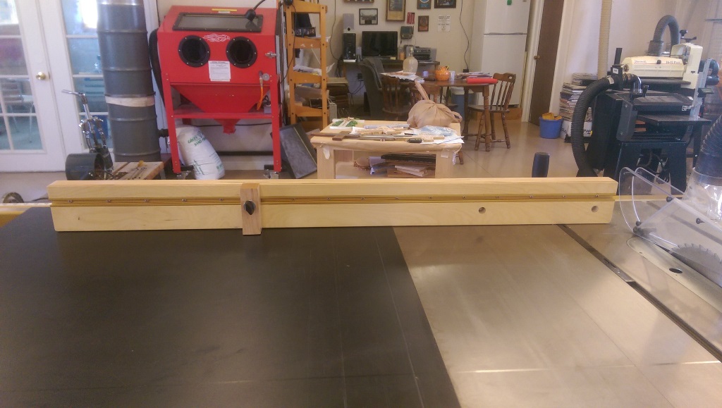

I don't have the sled mounted right know because I am polishing 10ER parts. However, it is 37 3/4" front to back between the fences. If you pull it all the way back with the blade fully raised it will cross cut about 30". If you pull it all the way back and cut through the out feed tie bar it will cross cut 37".
I also made an extra long aux fence for my Powermatic table saw miter gauge to cut narrow stock to length. It is about 48" long. Since it is so long it is made from two pieces of 3/4" Baltic Birch glued together so it will stay straight. Finished with 3 coats of Poly. It has a T track and a stop for repetitive cuts.

I was making raised panel cabinet doors. When I glue up the doors I leave the stiles long. When the glue dries I use the sled to trim them to exact length. At the time the widest door was just over 18" but I figured if I am going to make a sled I may as well go all the way.
