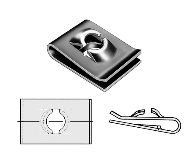

Ohgary wrote:Missing sheet metal screws should be available at the local real hardware store, a project for next week.
Gary
I wood knot expect you to know that the handle pointed the wrong way. Before ya go to the hardware store, make sure the tinnerman is still there.

"Tinnerman"?
Posts: 3814
Re: Assemble my 1983 model 500
Tinnerman nut. A.k.a. "speed nut", "sheet metal nut", "Tinnerman clip".
BuckeyeDennis wrote:Tinnerman nut. A.k.a. "speed nut", "sheet metal nut", "Tinnerman clip".
There appears to not be one in the pix.
Take the belt cover off and drop the motor pan to access the 'indentation' in the headstock casting where the clip mounts. You should be able to see other tinnerman nuts for all the screws just removed.
Actually the screws be 'self threading' screws rather than sheet metal screws. Do not confuse self tapping screws with self threading screws.

Actually he had the lever removed and stored in a tool box. No need to raise the table for lathe work, right?
