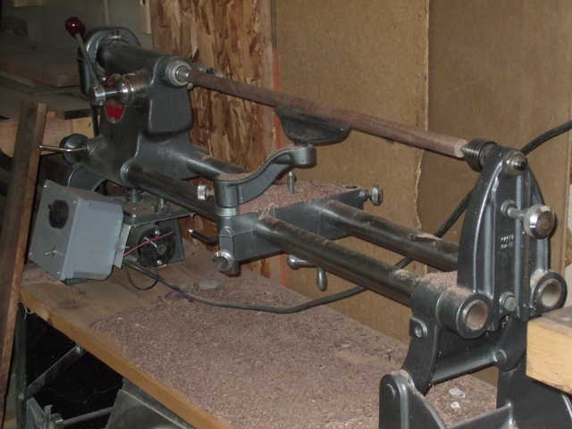

If there is one part of the SS that has bugged me over the years is that tail stock. It is way too flimsy. I am surprised that SS has not made an upgrade over the years that fits on the way tubes and offers a rock solid tail stock.
Paul

masonsailor2 wrote:If there is one part of the SS that has bugged me over the years is that tail stock. It is way too flimsy. I am surprised that SS has not made an upgrade over the years that fits on the way tubes and offers a rock solid tail stock.
Paul
Try putting it on the left side! Mine tailstock is a little loose when mounted in the usual position on the right side but is rock solid if I put in the left. Of course, you'd have to remove the headstock and carriage and turn them around....
Paul
They did, once upon a time.
It's called the 10ER! (With apologies to skou, for stealing his thunder :D )
